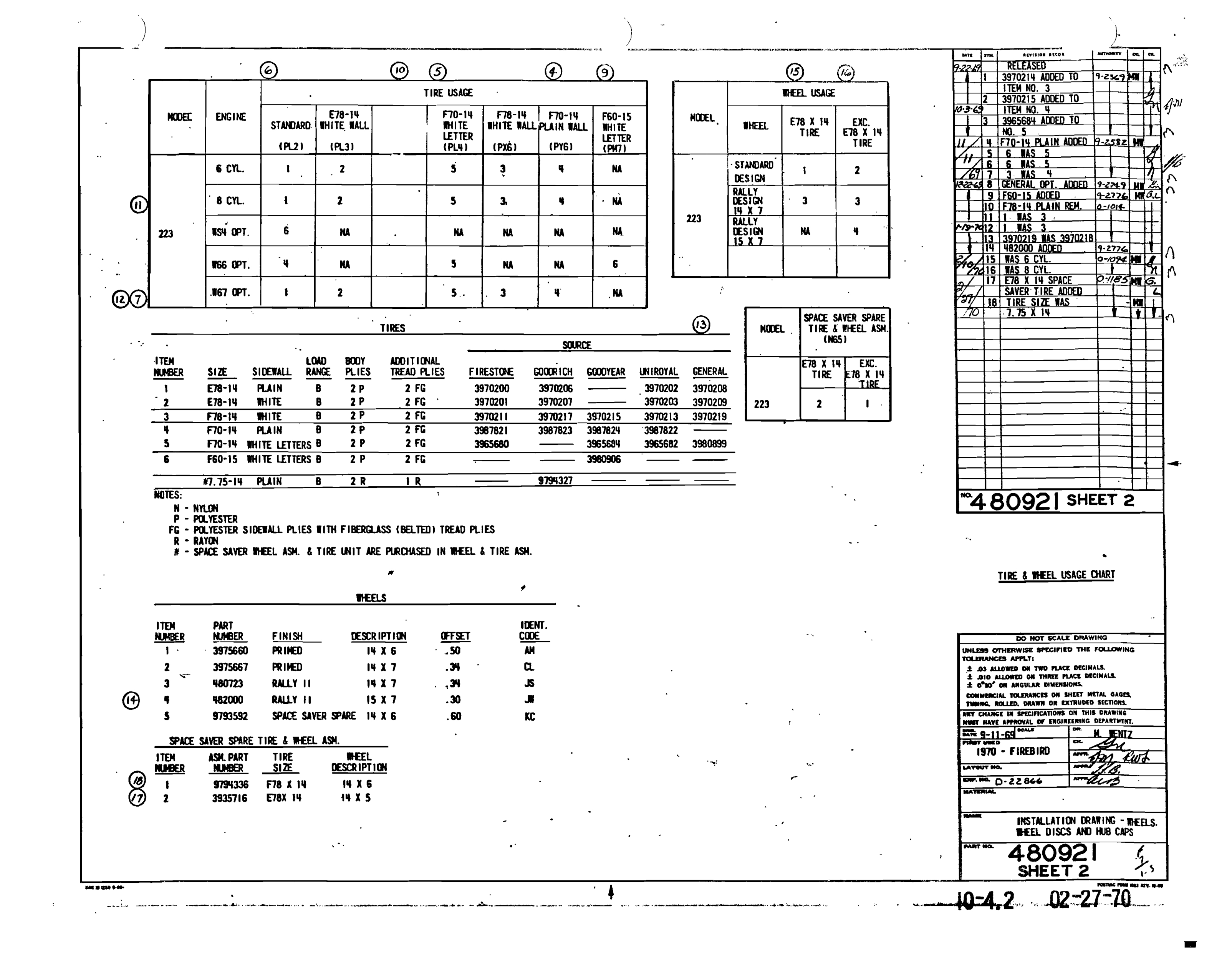

Old 05-19-2019, 10:03 PM
Held for Ransom's Avatar
Posts: 9,274
Look at the assembly manual late today and found they changed it from 6 cyl/8 cyl to E78x14/rest.
Still no 14x6 Rally II.

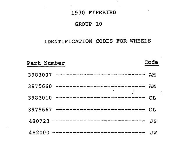

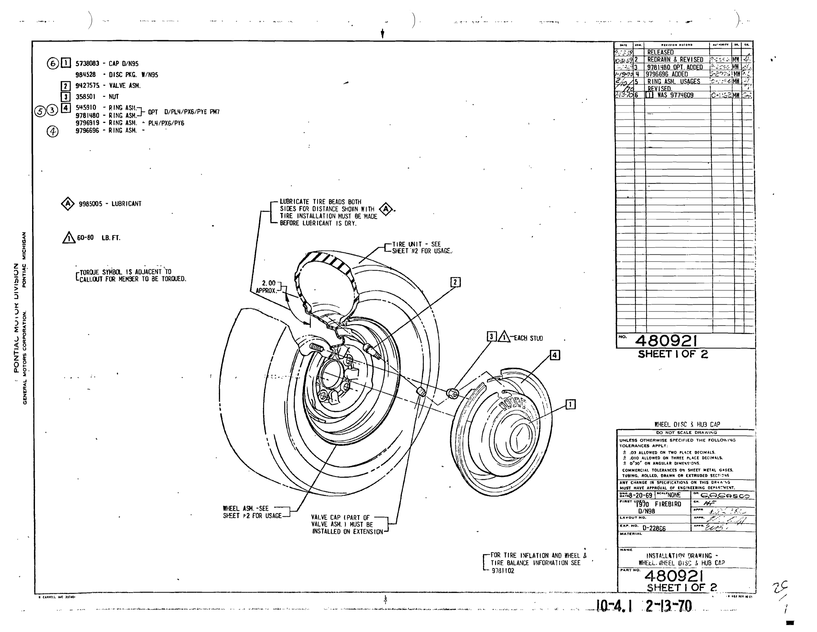

Old 05-20-2019, 08:59 AM
Posts: 21,915
Higher resolution pic of HFR pic.
70 Bird Wheel Usage
And the 1st page:
70 Bird Wheel
Also ID Codes:
70 Bird Wheel ID Codes

... Still no 14x6 Rally II.
I apologize if I have caused any confusion, I will look into this and properly reply when I find the source I got that information from.
I actually find it curious that no 14x6" Rally II is listed.
In the absence of a 14x6" Rally II (which was offered on other Pontiac's), and since both base and Esprit came with 14x6" wheels (c/w E78/14 tires);
It would seem to me at least that either a 14x6" Rally II should be listed somewhere, or opting for the Rally II on a base or Esprit (W67) would have required an extra cost larger optional tire.
The chart seems to make it quite clear than anything other than an E78/14 tire requires the wheel width to be changed to 7" wide.
1970 Formula 400
Old 05-21-2019, 05:57 PM
Join Date: Apr 2000
Posts: 9,779
JO coded 14x6 rally II's were manufactured, I've had numerous of them over the last 35 years. All were dated in Jan & Feb of '70, & from only ones paint penned, came from a '70 Bird. Have sold or traded multiple hundreds of '67-72 useage original Rally II's, tons of clean matched dated sets, & I've never had a request for a JO coded Rally II. From practice that particular medium depth notch 14" rally II wheel is good for one thing, & that is having the centers cut out for repro built JW's
