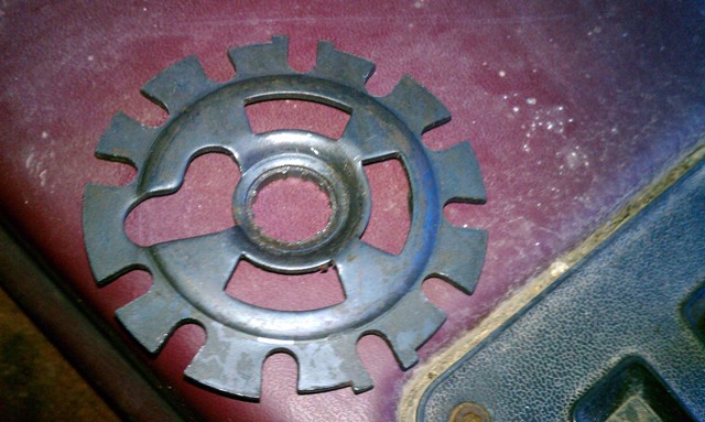

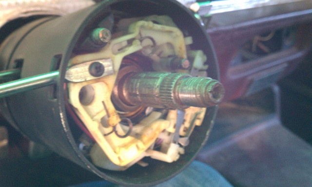

The column is put together properly. There is no "adjustment" of the locking plate and cancel cam, it only goes on one way. It is keyed with the teeth on the splines of the column. See the pictures:
So basically the smooth surface missing a spline is supposed to be at 12 o'clock but is instead closer to 10. The intermediate shaft to the steering column mount also has a keyed spline interface and only goes on one way as well. I just don't get how this can be so far off. The car tracks straight and level, but the tie rods are definitely not even (one is a good 1" longer than the other). I'm kind of stumped on this one right now.

This is an easy solution.
First, is your alignment good...no unusual wear...car was driving straight with the old column.
If yes, which sounds like it.
Position your wheel so tires are straight and then use a round file and remove one of the teeth on the inner dia of the locking ring....so, you are basically "re-clocking" the lock plate to correct your steering wheel issue.
As it sits now, your "wide gap" shown in pic is at 10 o'clock.....with wheels pointed straight forward.......so make your rock plate with a gap at 10 o'clock which will reorient the horn contact which dictates wheel placement and you are done...should take you all of 5 mins to correct this problem.
