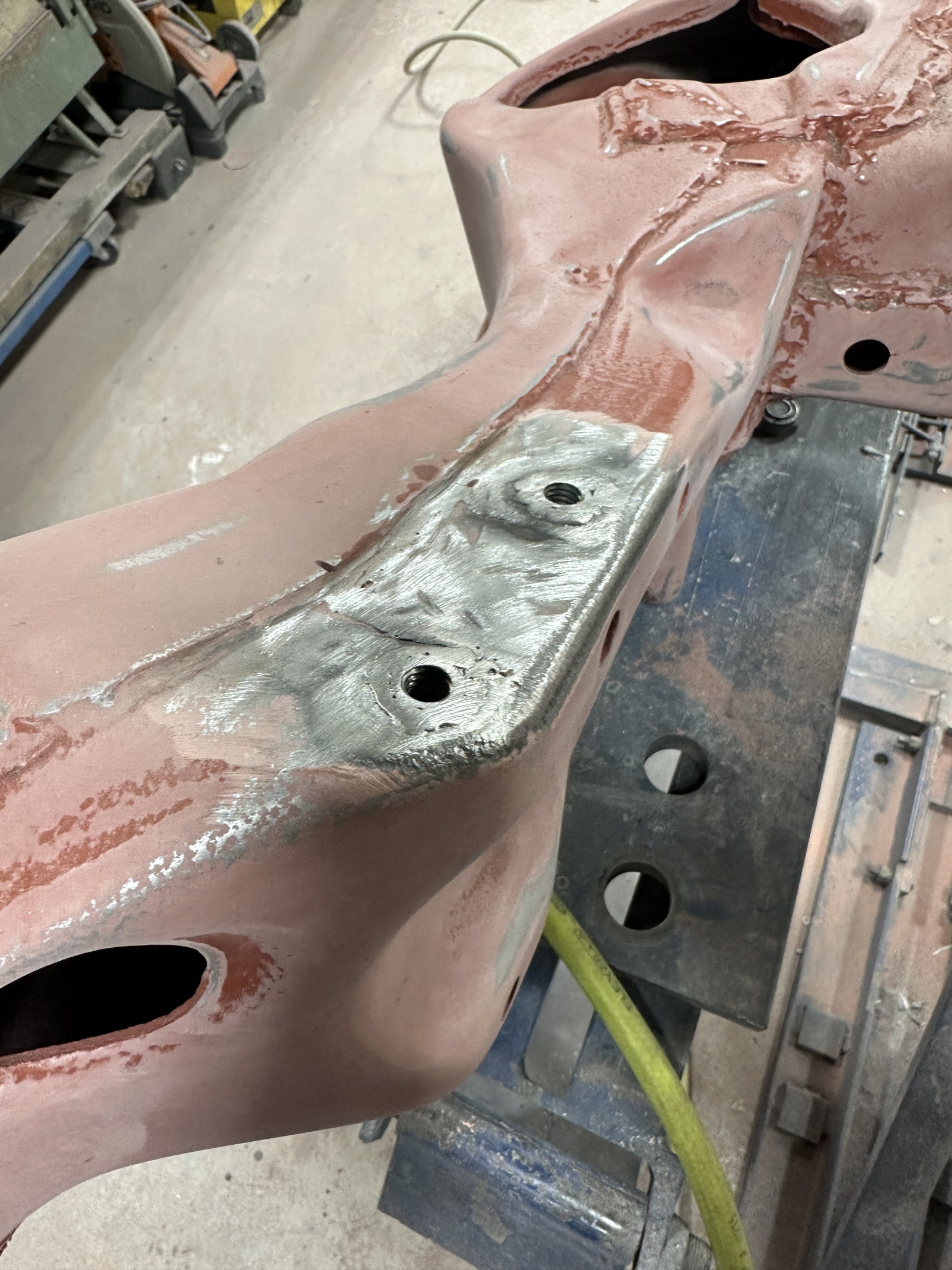

Subframe in first round of bodywork and primer. Fixed the sway bar mounting points. It's getting pretty smooth!

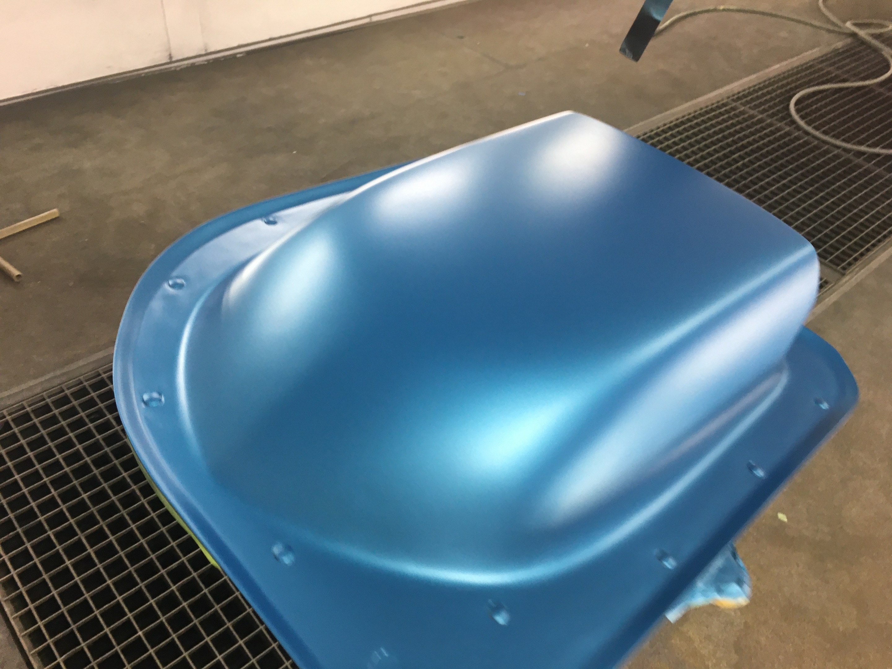

A little dash of color!

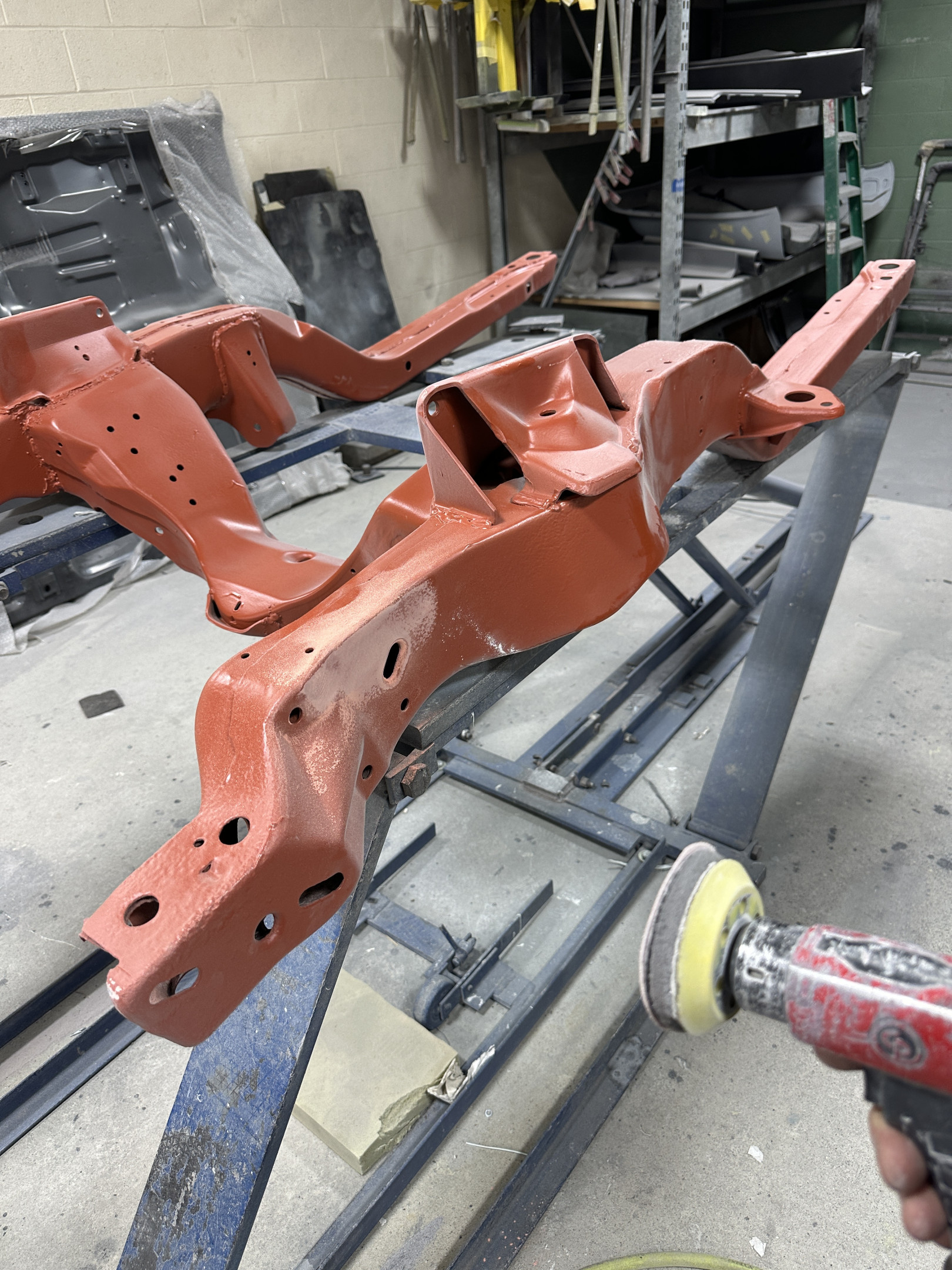

Doing final bodywork on the underside of the car. Smoothing out some things, little block sanding and will be primed for the final time.
