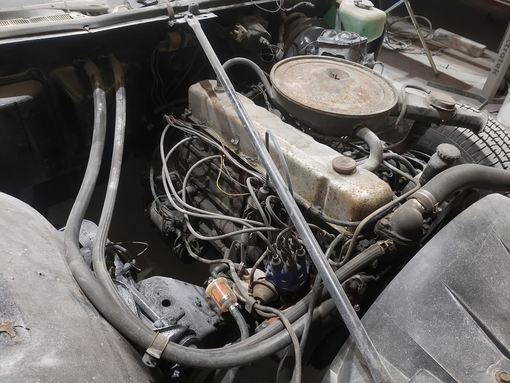

You could still get the 6 cylinder and 3 speed manual on the column in Canada as the Laurentian until December 1970 or so. I've seen only 2 and here are pictures of 1 of them. I know it's a Canadian "Pontiac" but these were the standard GM frame and not the smaller Chevy-frame-Pontiac-trim-n-badges cars of 1970 and earlier.

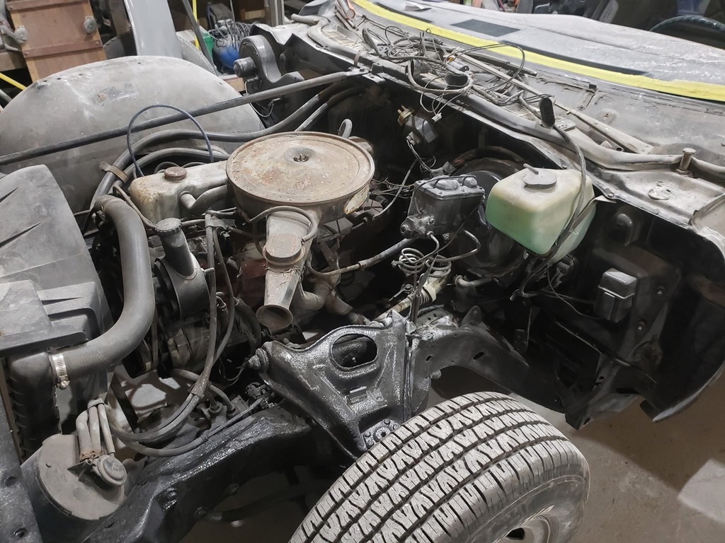

Things to note on this car:
Extra long brace between core support and firewall unique to 6-cyl cars - 1971 cars had either 2 or 1 brace that went to the inner\outer fenders and not the core support.

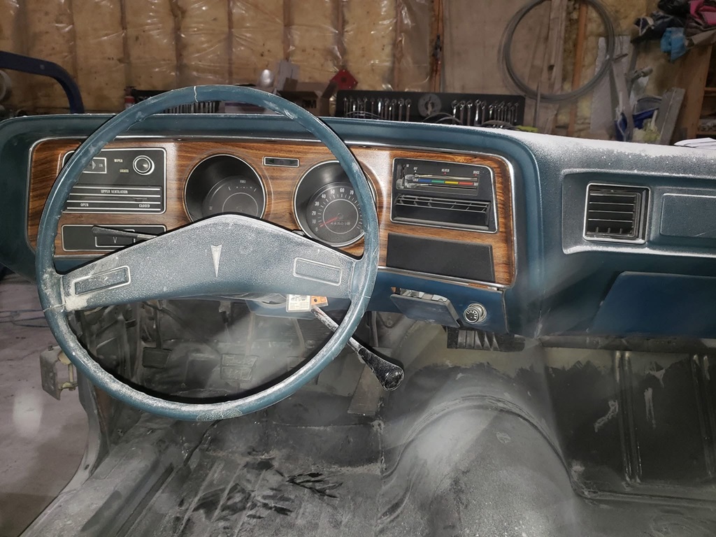

As best I can tell, this car has potentially only ONE option. It's got no AC, no clock, no radio (check that delete plate), base steering wheel, no nothing... except power steering. Yes, if you read the original literature that GM put out for 1971 you can find references to power steering being optional on the 6 cylinder cars. I suspect that without a build sheet for this car that the literature may have said that, but in reality no one wanted a car this big without power steering so it was probably standard by the time the car was built.
Power disc brakes were always included in the 1971-1976 B-body line, even the basest of base Chevy cars.
Check that tiny radiator. You can see from the picture that this car has a 2 row radiator. I had a 1971 Catalina 455 4bbl that someone one of those in and I was amazed they even made them, much less someone put it in the car. It did not keep the car cool. I would have imagined that they would have just put 3 rows in every one of these cars, but apparently the base Chevy cars and some Canadian cars (6 cyl and 350-2bbl) came with 2 rows. Crazy to think about and the best I can think of is engineering had a reason for concern about keeping the passengers warm in a timely manner in the winter up north or they had them from a previous car line or design and used them up to get rid of them.
