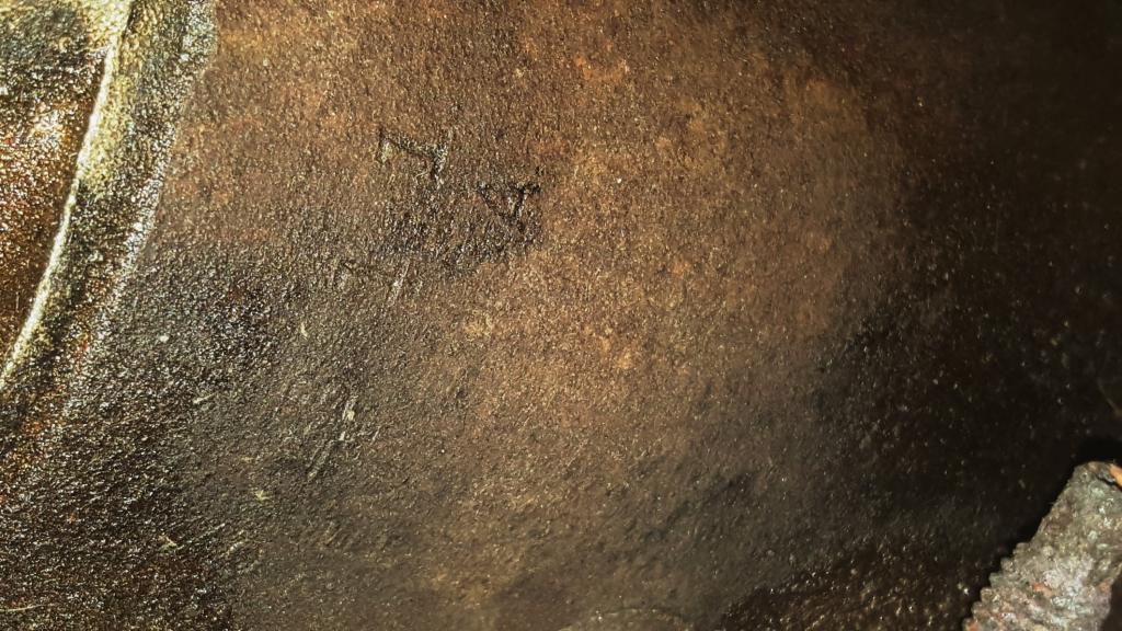

I have a request for SD455 owners out there who have (as far as they know) the original starter for their car. What is the part number and the date code on your 1108436 starter?
As you may know I just had my 19,000 mile Formula in the Vintage Certification judging and I received a zero point score for the starter because it had a date code of "1B11" which would be February 1971, more than two years before the car. None of the prior owners ever replaced the starter. At the time of the judging I had no idea that the starter date was that far away from he car build date, otherwise I would have checked on that issue beforehand.
I asked Frank.G to check his starter on his unrestored survivor SD T/A and low and behold his original starter has the same exact date as mine! 1B11. His car was shipped 20 days before mine (6/29/73 versus 7/19/71)
Please crawl under your cars when you get a chance (this gives you an excuse to get away from all the annoying relatives in your house for Thanksgiving right now) .
Here's a photo of my starter and Frank.G's starter.

I'm sure you meant to type 7/19/73. I was going to question why you received zero points, instead of partial because of correct PN. But understand you were not the one doing the scoring (I'm not one to question a judge but..., let's just leave it at that). With the shut down at the end of the '72 year and the late build of the '73 SD, I wonder how many they had stockpiled. '74 was a different PN.

Hand built engines got their own pallet/bin of Starters, balanced parts, Bolts, manifolds, Pumps and hardware to pull from. The SD was Being built in '72 ( there is one example in existence ). I am willing to bet they ALL had date similar starters due to this process. The engines were in their own "Sub Assembly" area, with their own stock of hardware.
This has been seen in BBC Tonawanda engines that needed some hands on at assembly Time, Also in Flint Built Z-28 engines.
If the SD had a M13 ordered for it, the Transmission could be OVER a YEAR older than the car and be correct for it.
With The originality of the car verifiable, I would stick with your Starter, I am betting its original.
I serviced a '73 SD Trans Am at the Dealership in '78 for overheating, it had only 4,000 miles on it and was Not from New England. Warranty work. First thing I did was look to see if it had a heat shield on the Starter, and I gave the starter numbers to our parts guy to see if it had the correct starter. I distinctly remember him saying it was a "late 71 starter" and should be fine. Heat soak with unleaded fuel and smog equipment was bad in those days. I ended up leaving the starter and Pulled the Pump and changed the divider plate ( we stocked them due to rust ) , and put in a 160 thermostat ( that part was NOT warranty, was my convincing the owner to do it) Quick Flush and out the door.
Don't Discount the The fact that the easiest way to get a engine built may not always follow the "rules" for casting dates or stamped dates.
-- my 2 cents having seen / owned some non correct, BUT Still original cars...

DOH! you are correct Sir. I meant 73 not 71.

This just in: the head judge at Vintage Certification just researched through one of the prior cars they judged a few years ago: the 1,700 mile SD T/A. And it has the exact same starter part number and date code! So, combined with the info from FrankG's car and mine, it looks like we just added some valuable info to the book on SD parts.
We are getting those points added back in to our score! Excellent!

I just crawled under my '74 SD-455 and checked the codes on the starter and just as Held for Ransom stated, it has a different part number. It reads 1108226 and the date code is 3L51. That translates to 1973, December 5th, 1st shift. So I guess by the 1974 model year, they got more up-to-date with the Super Duty starters.

Add another one to the 1B11 list. This is the starter from the 11,000 mile, formerly flame painted, SD455 4 speed that was at MCACN last year. So far everyone I have contacted with an unrestored 1973 SD455 with gapless provenance has yielded the same result of 1B11 date coded 1108436 starter.
