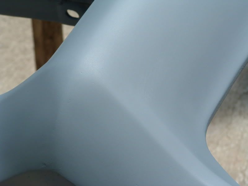

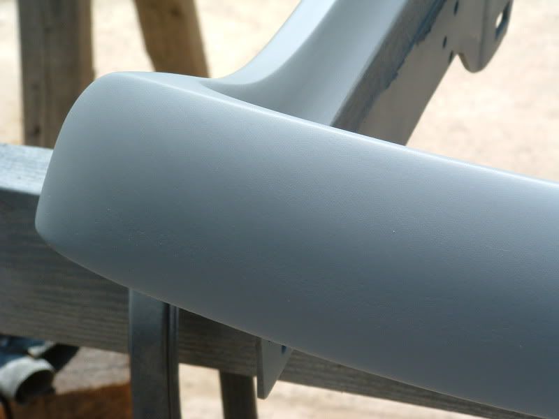

I resprayed today and it looks much better. Still has some flaws....Kinda like a beautiful woman in direct sunlight. Still looks nice but you can see the blemishes here and there.
I'll sand it tomorrow and and keep respraying as long as I need to. Looks MUCH better today though.
Here's what it looked like after the first spray-
MOSTLY looks like this now-
Still have a FEW spots like this though....
