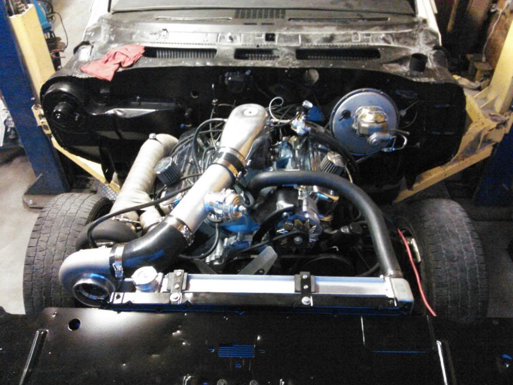

Took the first test drive tonight in my 1970 turbocharged 350 Lemans wagon. It is going to be fun!(once I finish installing body panels) Pulled really hard for a completely stock 350, buying up parts to build the replacement engine currently Forgive my horrible video editing skills.
http://www.youtube.com/watch?v=MXUd1TmB2Vk

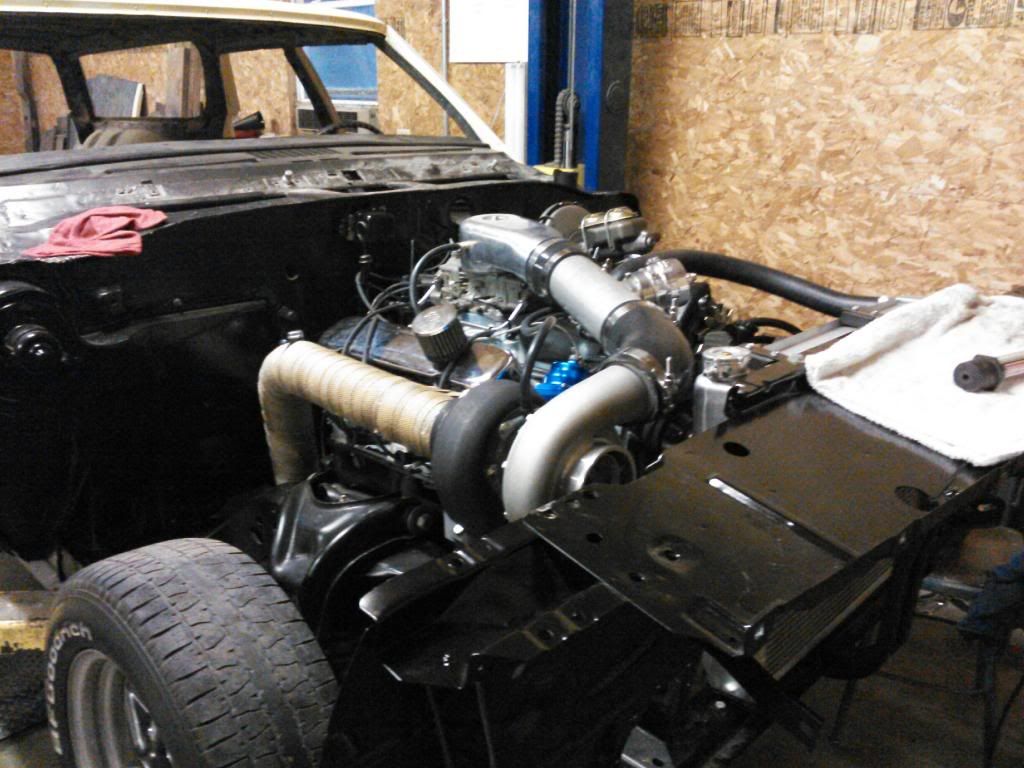

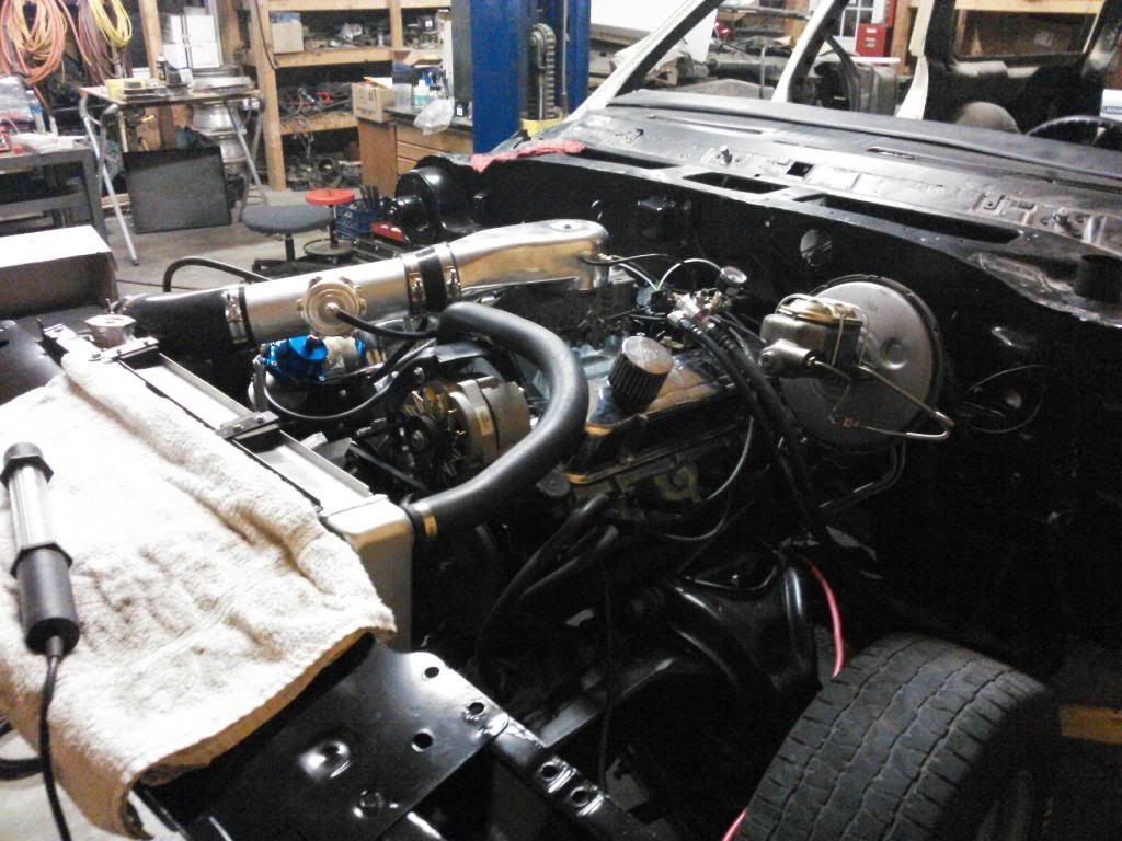

Thanks! I won't have anymore videos until later this fall when I get paint and some body panels on it. I could not resist taking it out for one blast down the road . I will start my own thread when I get some better pictures and have time to write down more details of the build. Highlights of the build are cheap Chinese gt45 turbo, completely stock 350(for now), lots and lots of fabrication and using parts the way they were never intended!
