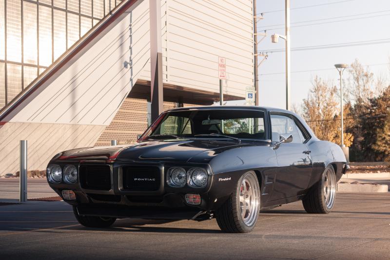

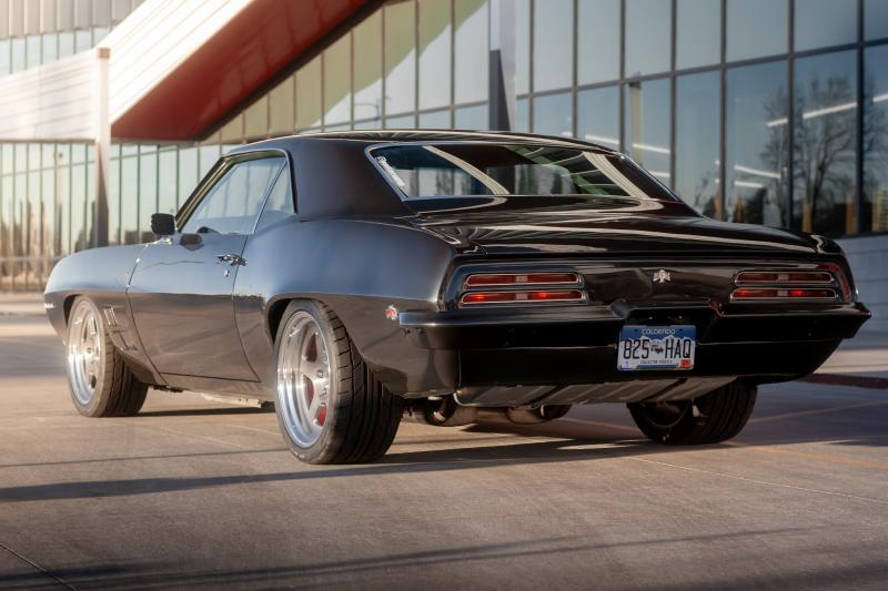

JLMounce 12-04-2024 04:16 PM
2 Attachment(s)
It's hard to beat a 5 star wheel. I like the multi-spoke stuff, that's what's on my wife's corvette, but a simple star design will tend to hold up in style over the years.
