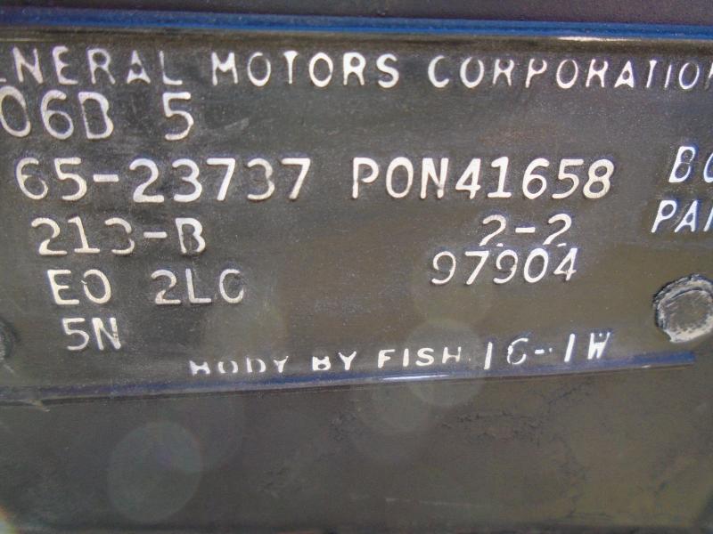

Wow, Thanks alot, It does have that code on cowl tag, Can you Please advise how you know this info, Thanks again.

[QUOTE=68goatsolarred;6552716]Wow, Thanks alot, It does have that code on cowl tag, Can you Please advise how you know this info, Thanks again.[/Qjpg.gif DSC01347.jpg (27.0 KB:UOTE]

68goatsolarred 02-24-2025 11:54 PM
Tried to post cowl tag on your post, I was able to get it on mine, Thanks Again.
johnta1 02-25-2025 07:43 AM
Cool car.
The tag decode of the lower letters:
E - tinted glass
O - 2 tone paint
2LC
C - instrument panel pad ?
L - Muncie 4 sp
5N
N - GTO

Thanks Johntal, I was trying to post the cowl tag on Baron Von Zeppelin, To let him know It's a 65 GTO Tiger, I have the phs, But wanted thank him for his help. Thanks for your help also. Goat guys help each other out!
Baron Von Zeppelin 02-25-2025 12:08 PM
97904 is the Dupont paint mix formula number for Tiger Gold.
When they have that listed , it is for certain the special color was Tiger Gold.
I'm not too sure "O" in EO stands for 2-tone paint.
That doesn't quite jive right overall.
Possibly it is just the Fisher code that makes provisions for the molding group that divides a vinyl top or 2-tone paint scheme.
Im thinking the second 2 in 2-2 trim code is for black vinyl top.
It would be extremely ultra unusual to have a 2-tone with 2 different special order colors.
Don't think that would fly with the zone order proof readers.
Seymore might can scour his original 65 PMD build sheet and see if any of the numeric box groups list a code for 2-tone or vinyl top.
And we can decode your PHS document to see if it has one of those.

Thanks Baron, Thats Awesome.
johnta1 02-25-2025 02:04 PM
I'm not for sure on the 'O' some stuff I have says 2 tone, some say the molding strip that separates the upper and lower halves.
Since it's on the cowl tag, it would pertain to the molding strip I guess.
:confused:

The buyer odered it with a 2:23 pos, (per phs) If you look on the cowl tag it has the dupont paint code you said was Tiger gold also it was built last week in June, Not sure if you got to see the tag, Its definatly on my posts, I am having trouble loading pics up on the py forum. also I do have the pmd plant build sheet, but its hard to make out very blury, Thanks
Yes I saw your cowl tag pics. Bonafide
Probably meant 3.23 axle with Wide Ratio 4spd
The factory build sheet is an item that is only found within the car itself , on rare occasions.
Keith has a pristine example.
What you probably have is the Billing History Card from PHS.
It does seem like most of the Metal Roof Tiger Gold 65's I can recall had Black vinyl tops.
Probably more to do with the color ads in magazines prompting the choice.
That would add another chunk of coins to the sticker price on top of the extra charge for special paint.
Someone from back when might actually know if it was a requisite to get the vinyl top with that color , but I have my doubts about it.

Thanks Baron, Yes this one was ordered the black vinyl top (per phs), Thanks Again for all your help.
Yep , more likely.
Being it's a Fisher Body code , it would be for the molding provision operations.
Which could apply to either vinyl top or 2-tone cars.
