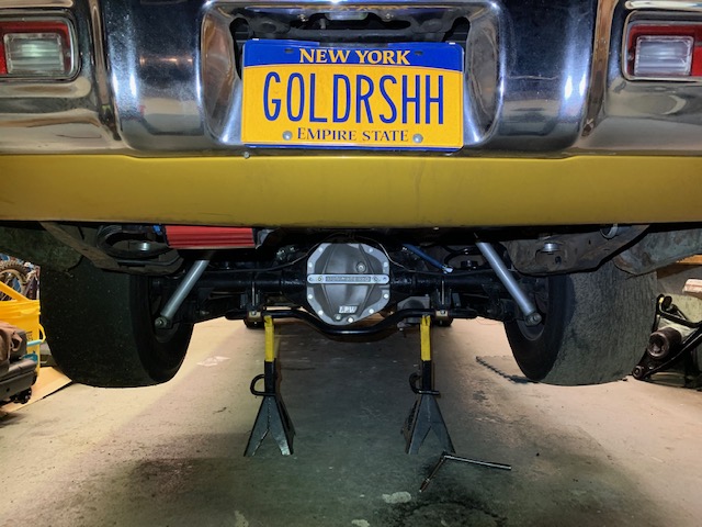

JSPONT 12-16-2020 03:12 PM
S60 looks badd azzz!! just sayin
Attachment 556264
