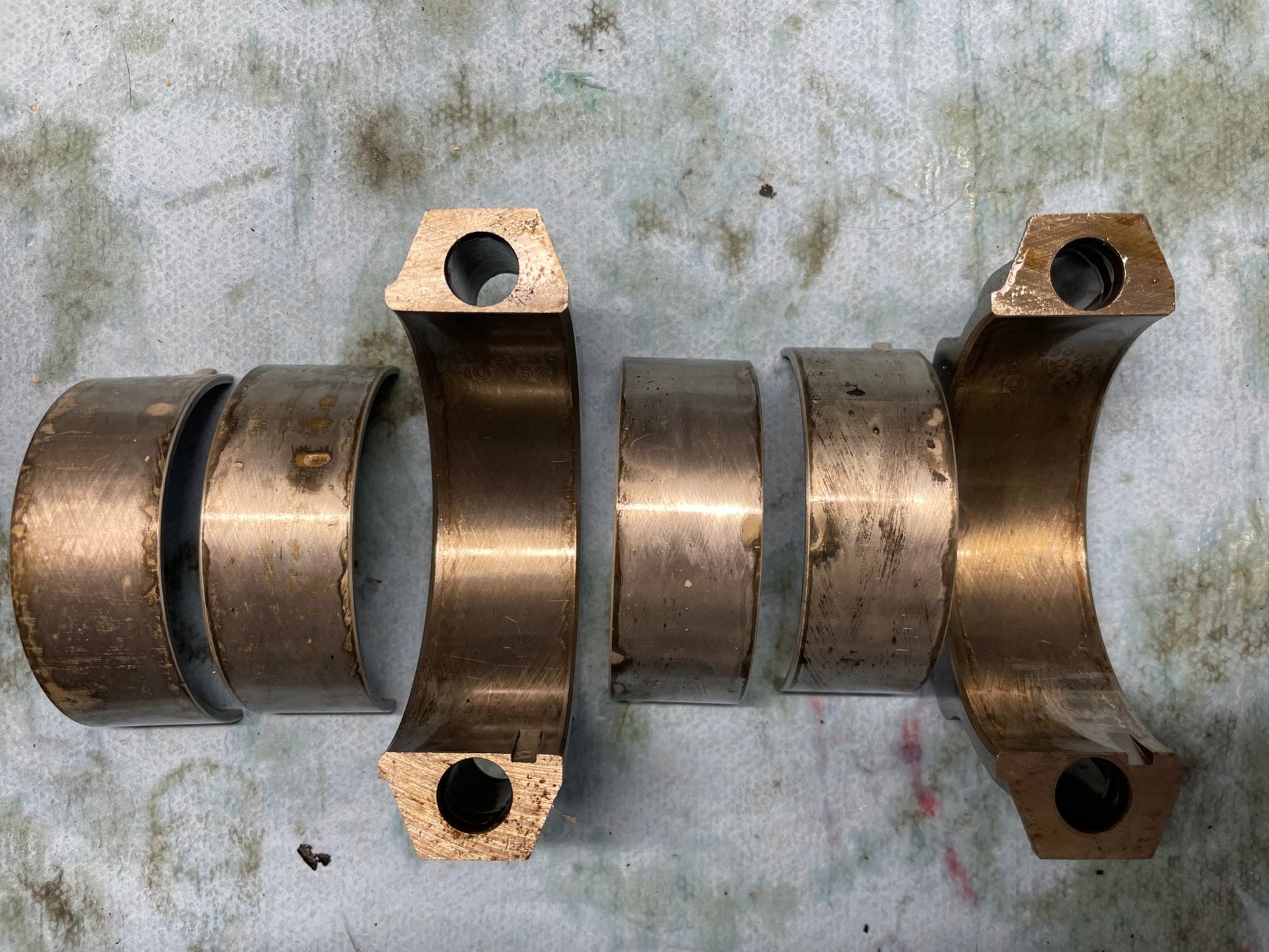

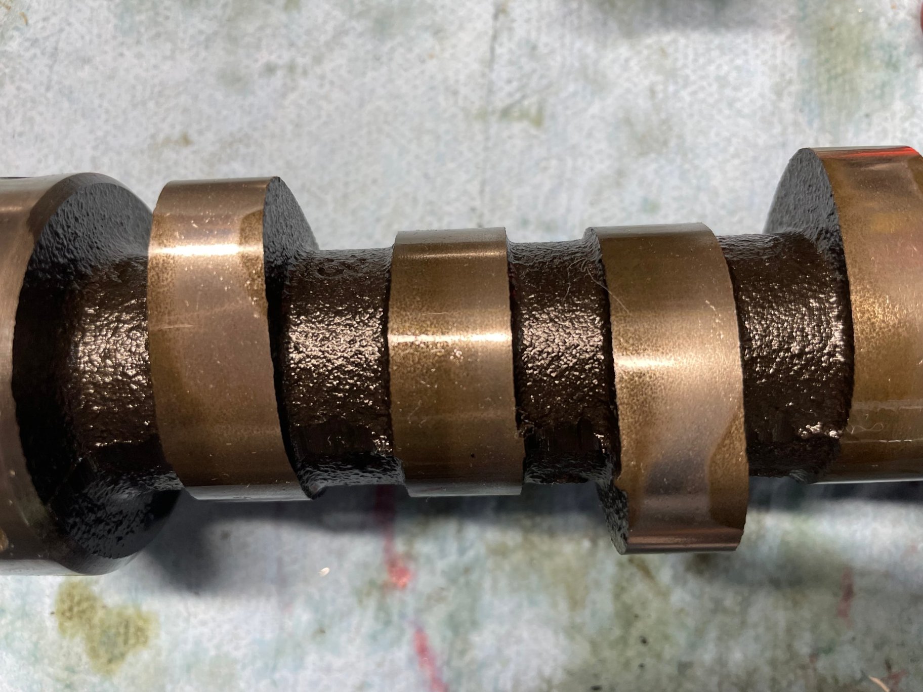

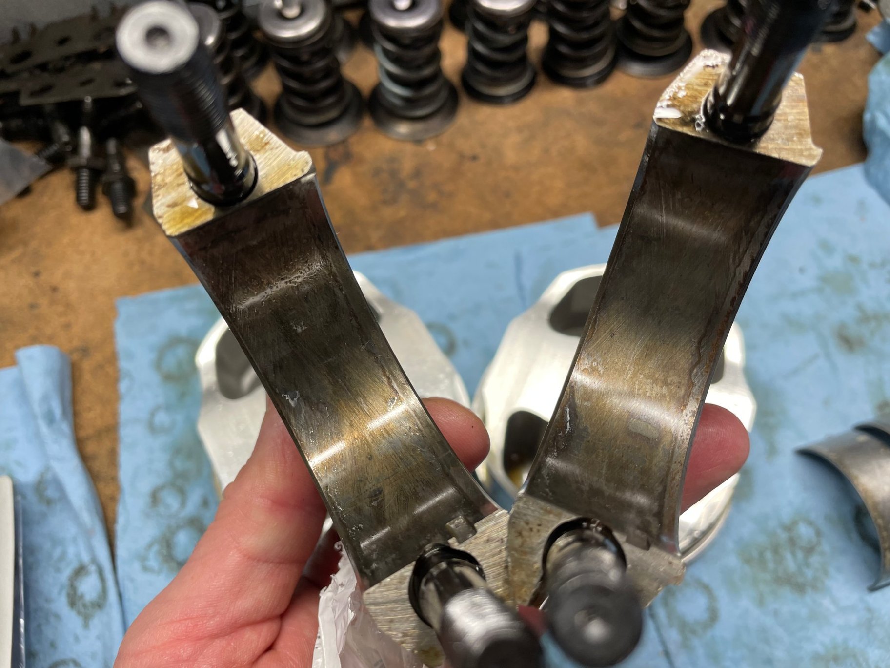

Alright, here' s the carnage. Bearing caps are more roached than the tops, the rod ends are generally hammered.
Crank journals aren't too bad, but will likely need some cleanup. The crank is .010/.010 and the bearings are Clevite 77. Pretty sure I recall the machinist saying he line bored the block. It requires a .005 under timing chain. .010 is too tight, regular set is too loose.

charlie66 01-14-2022 02:53 AM
Do you think maybe your clearances were too tight? Clevite does seems to run tight usually. Looks like the crank can be polished . Not to bad.
Depending on what you are willing to do at this point , You could give the block a good cleaning , polish the crank and get a good set of new bearings and put it back together. I personally like the speed pro 113M 3/4 groove mains . I rev my motors to 6800 to 7200 . I never have any bearing issues.

Might want to start with a good look at the crank.

Ouch - these much better pics point towards a minimum of polishing or turning the crank .010 and new rod/main bearings, including R&R on the cam bearings.. What we are not seeing is what is the cylinder bore wear given whatever happened in this engine that scored the bearings. (Dirty or wrong oil, what was found in the oil pan?)
If this was my engine, I would have it at a good machine shop, turn the crank, hone or bore the cylinders, new pistons/rings if necessary, and as long as it is disassembled, get it balanced. Then you have piece of mind and a reliable motor going forward. Yeah - this costs much more $$ than just bearings, but eliminates spinning a rod or main bearing, or god forbid throwing a rod. That was exactly happened to my Bro when we cut corners on his rebuild

I agree with Lust4speed. Hard to tell in the pics but that caught my eye first.
Couple of the journals also look pretty scorned to me. Much more so than journals right next to it. Enough to make me think the crank may need to be turned. But I'd have what ever it is showing up in the picture checked first, it might be done anyway.
Certainly appears the engine had some trash running through it. From the way the mains look it also gives me the impression that the main bore alignment needs to be revisited again.
Upper rod bearings do have some wear, but not as bad as some I've seen with engines that had known detonation. If this is just basically a stock engine that could most likely be dealt with in the tuning or maybe fudge around with camshaft selection a bit, but I'd be more concerned with the other problems at this point.

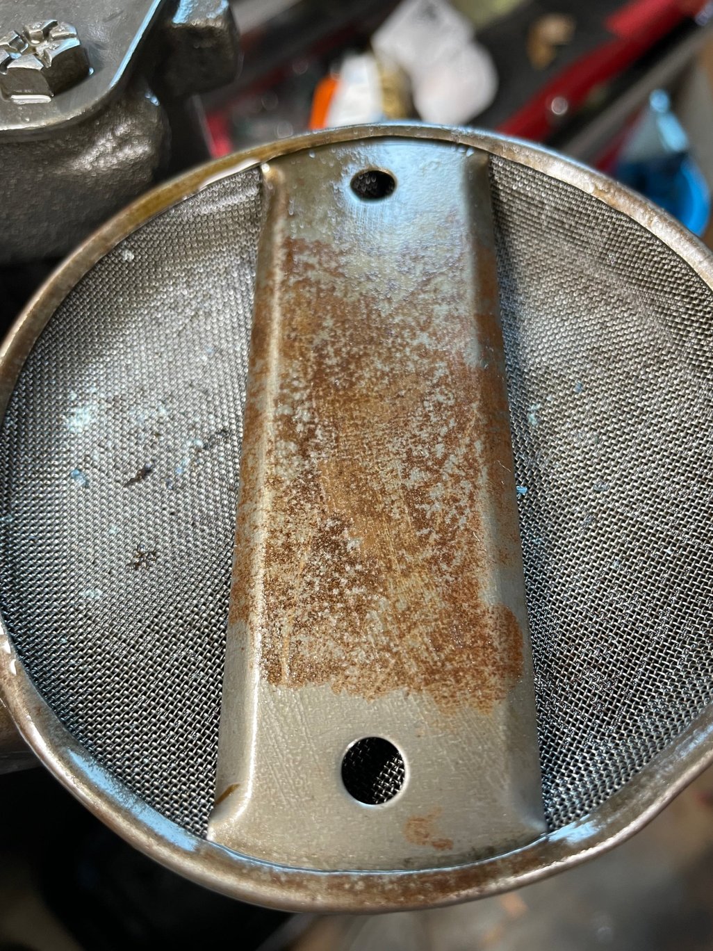

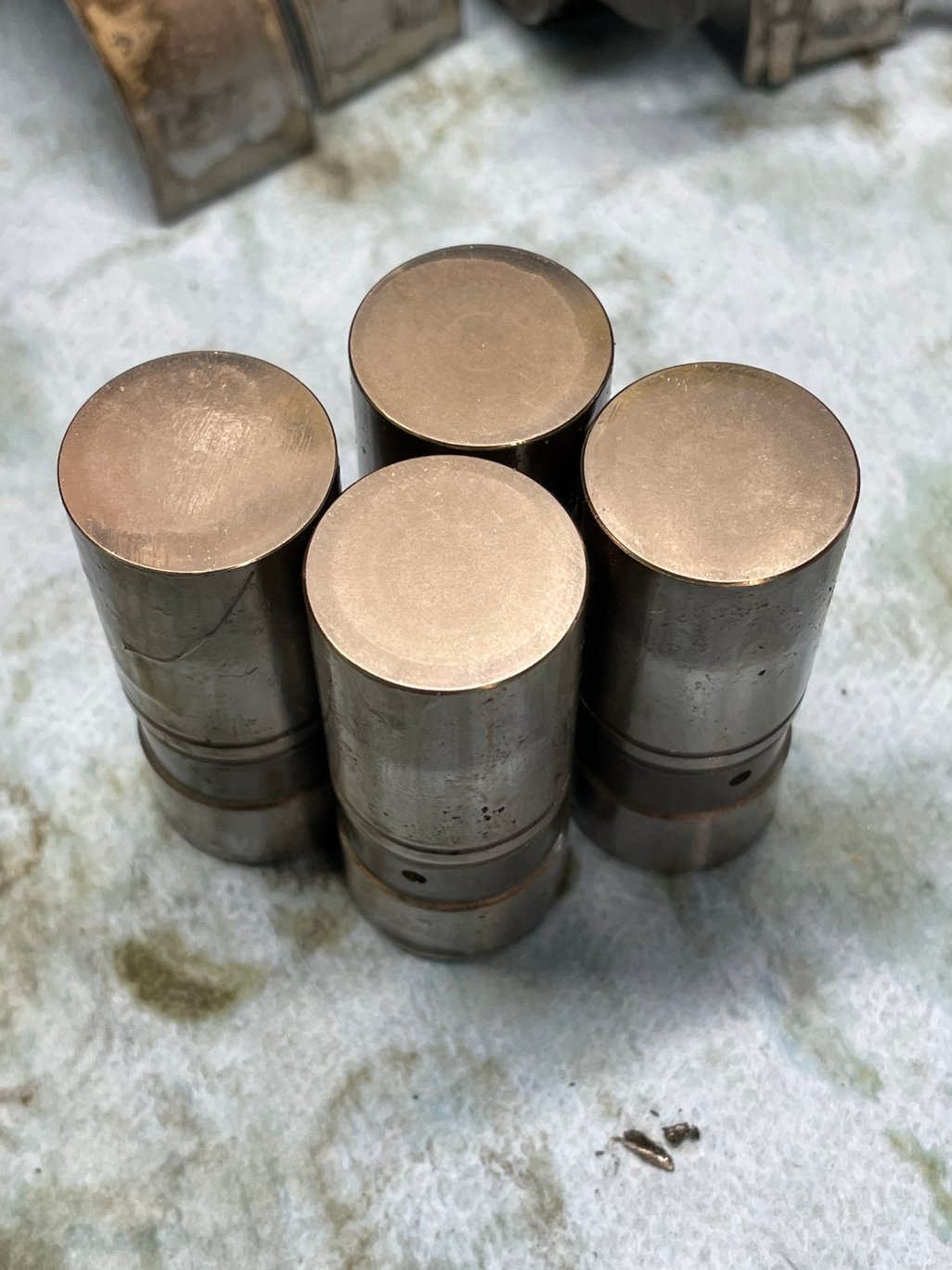

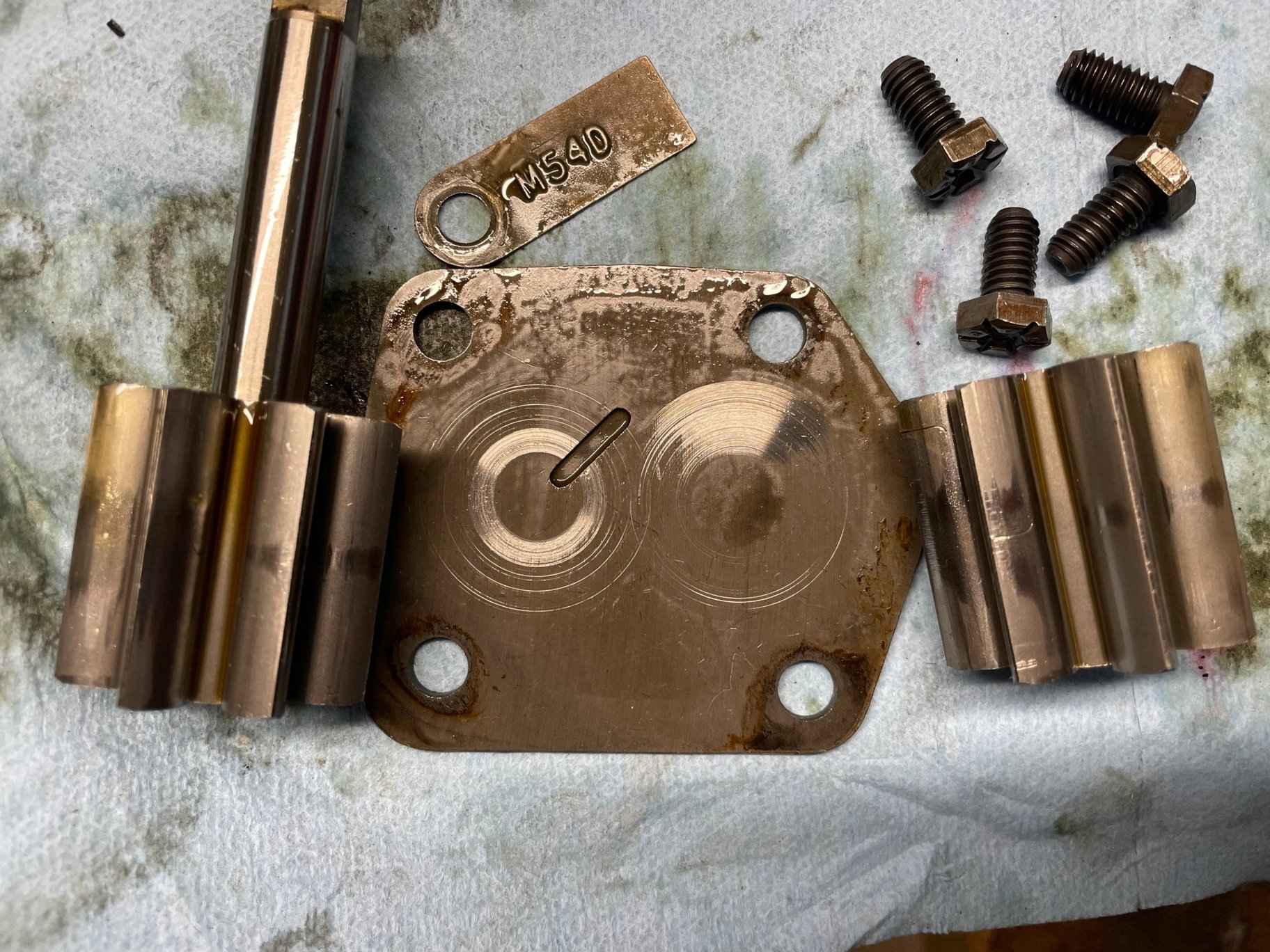

When I was dissecting things last night I found a tiny piece of blue material in one of the crank oiling passages. At first I thought it was gasket sealer, but this morning it clicked and I think I know what's responsible for most of the damage. Early in this engine's life the valve spring retainers destroyed most of the valve stem seals because the valve guides weren't cut down far enough. The valve stem seals were blue.
I found a lot trash in the head when this happened, but obviously not everything. I was expecting to find some of it in the oil pump pickup, but I think it was obliterated into tiny pieces and passed into the oil. I think there's even an old thread about here somewhere, the pic below shows how hammered the seals were. Totally makes sense now. That little blue piece I found in the crank looks almost exactly like the piece sitting above the right guide in the pic.

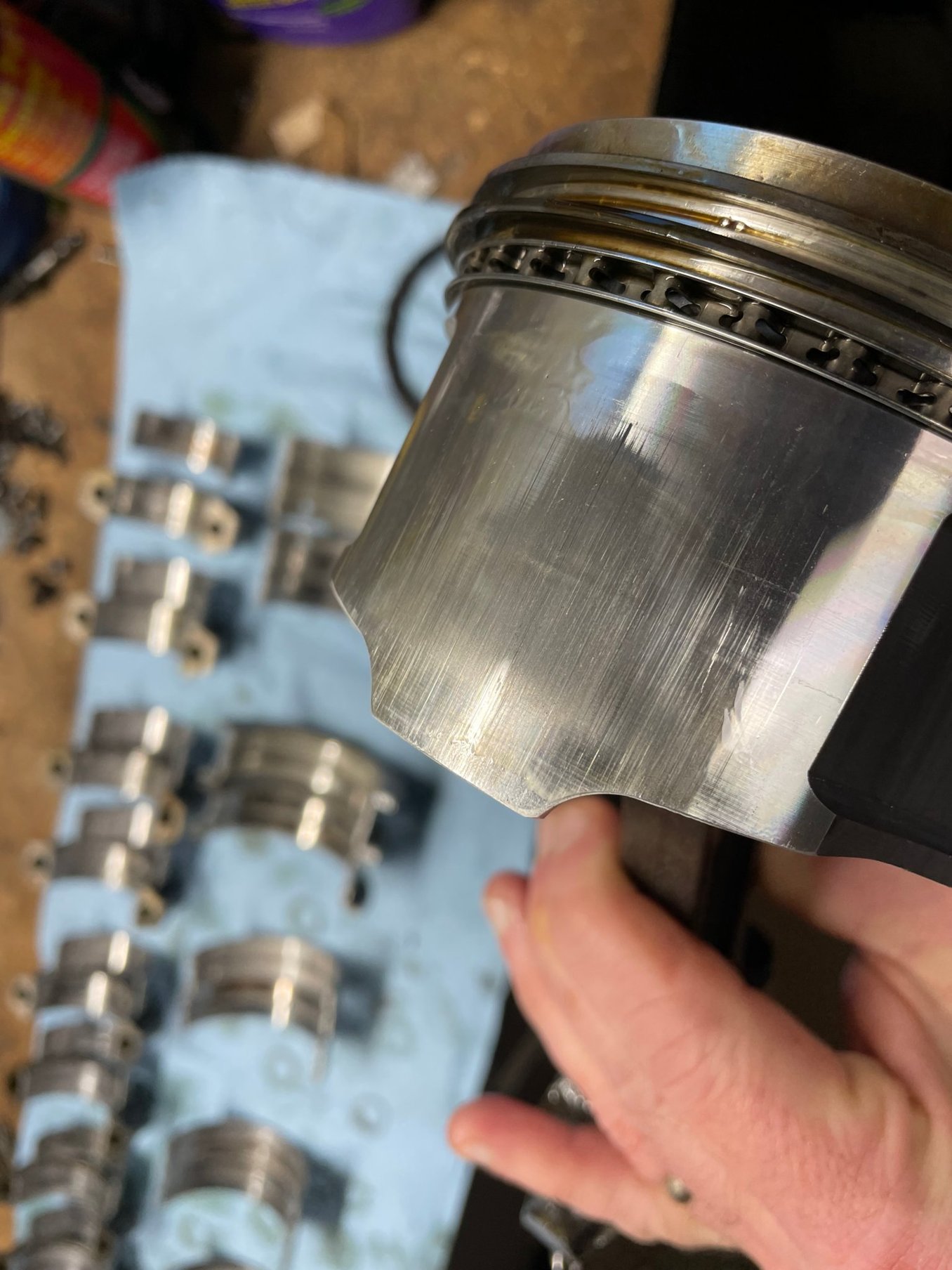

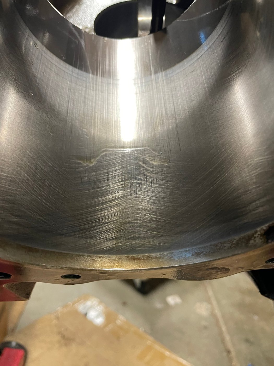

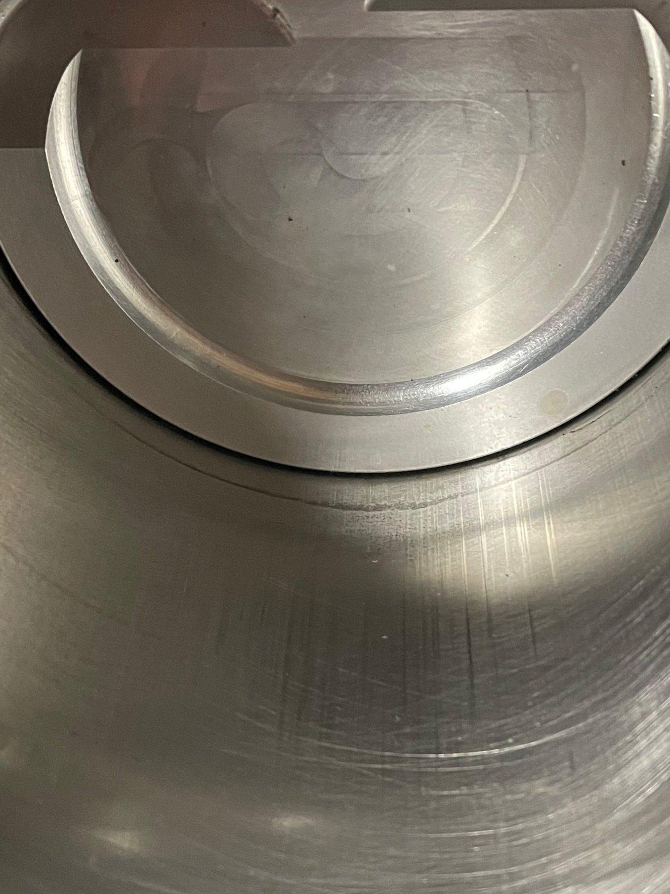

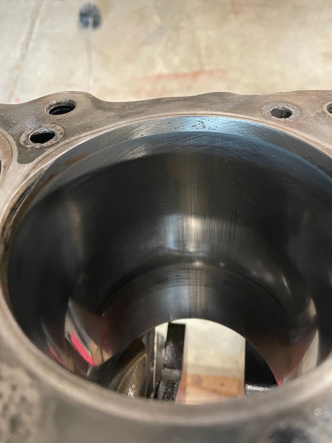

The bores aren't horrible but have some scuffing. Pistons look a little worse on the sides than I expected. A good block cleaning is obviously in order, maybe a hone, and definitely some machine work to the crank. I reused the stock rods when this was built in 2011 and always regretted it, so I'm about a step away from ordering up a stroker kit and starting over.

Sirrotica 01-14-2022 01:51 PM
Looks like a ford that has too much clearance, seen a lot of fords that look the same as this does. All the bearings, rods and mains down to copper. To repair them it always took a crank kit, with new bearings to get everything back to spec.

Bro - you take good pics which helps analysis. Not surprised of the piston wear versus the bore wear, looks like a little piston slap was going on, more common with forged pistons being a little "loose" if the block was honed/bored and not clearanced correctly (forged pistons expand more than stock cast). And the Valve stem carnage - that is a machining and set-up oversight With bad valve seals, maybe some oil/smoke blow-by was going on?. Not at all trying to throw darts here, just some input based on experience.
Yeah, while I'm sure this isn't what you wanted to find or wanted to hear from others, when something like this starts it usually ends up going down a rabbit hole LOL

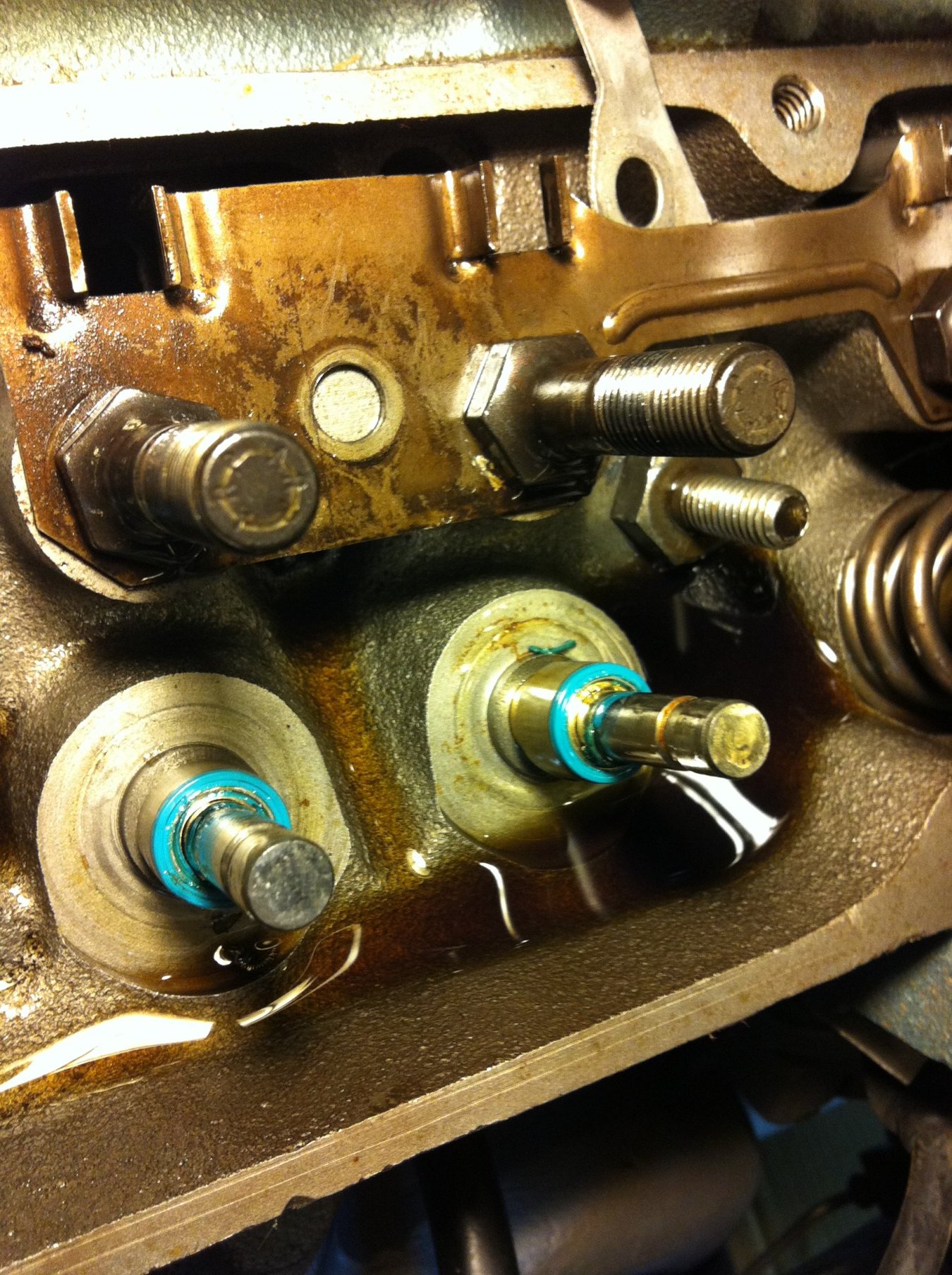

The valve seal issue happened in 2012. I pulled the heads, had the shop fix the guides, put new seals on, cleaned it out as best I could, put it back together and have been running it sense. Clearly the damage was done. Knowing what I know now, I should have pulled the engine back then.

lust4speed 01-14-2022 03:06 PM
OK, I'm confused. The photo in post #25 shows retainer to seal interference, but you say that was corrected back in 2012?
I'm working on a '69 RAIII engine right now where a lifter link bar rivet came out and the lifter turned sideways and plowed a nice furrow into the roller cam before being pulverized into pieces. I'm seeing less carnage on the RA engine than in these pics. For whatever reason his oil filter did a much better job of catching debris. His pistons were in good shape and we had the machine shop do a very light hone to get the walls cleaned up. My machinist is usually good but this time I'm thinking he could have been a heart surgeon - bores came back perfect and were less than .001" larger. You do need some exact measurements of current bore size vs. piston skirt size to see if there was a problem.
I think the crank journal ridges won't polish out and it will need to go another ten -- and it sure looks like there is a casting flaw present where the crank shouldn't have been put back in service the last time. I agree with not seeing any detonation signs and don't really see signs that the line bore was off. I'd expect to see some block upper caps worn and some bottom caps worn, but the wear looks fairly distributed. Might again point towards a crank that isn't running true in the bore either because of being bent or ground wrong.
You want better rods, I think the crank is junk, and the pistons don't look super but could be reused -- I'd go with a stroker kit and simply hone cylinder bores to the next .005" since you should be going with a custom dish size anyway. A good machinist can also measure and give you an exact compression height for the piston pin for the order.
That's right. The engine was built in 2011, I noticed the seal issue in 2012 and fixed it then, but trash was probably floating around the engine for a while. I changed the oil frequently and generally babied the engine over the last 10 years but it didn't seem to matter.
There are probably some other issues that contributed as well, like clearances. Will take a closer look at the crank, but considering the overall shape of things it seems like a kit of fresh parts is the way to go.

Oil pump needs to be blueprinted and do NOT need 80 psi pump, maybe higher volume, but not high pressure.

Unfortunately that short block in my opinion now needs a complete rebuild with oversized pistons again and a cut crank that is polished the right way!
Cast cranks due to there nodular carbon content need to be rotated in the right direction so these nodules do not stand up and slowly grind up the Bearing surface and itself from the grit that gets put out.
This added level of fiction also heats up the oil locally and can break down the oil film in that high load critical area!
Some shops leave the crank polishing work to the low knowledge shop helper who does not know the proper way to polish a cast crank, ( no less one that has been cut also! ) and then results like yours take place , or even way more Bearing damage from the much higher rpm and loading of a race motor.
Please also post up a few pictures of the rod caps without a Bearing in it and the back side of the Bearings that came out of it,
Here is what the Ferderal Mogul Bearing catalog instructs about polishing a cast crank.
PS.
This time use a one piece rear seal!

Also it’s no wonder that you drove the bottom of the exh retainer into the top of those positive valve guide seals with the lift of that Cam even with just stock 1.5 rockers, no less the 1.65 ratio ones!
The tops of those valve stems look beat, did a shop set those heads up for you?

Just to reiterate, the seals got trashed in 2012. At the time I was running a Crower 60916 with the 1.65 rockers. The shop set up the heads and assembled the engine. The guides were sloppy and uneven. IIRC, they had anywhere between 1/16 and 1/8 of a gap between the seal and the head. Ones that were higher obviously got more hammered. The valves have a little more history on them. They're Ferrea stainless valves that I bought for a 1998 rebuild and reused them with this build in 2011. I swapped to a Lunati 702 about 6 or 7 years ago and kept the 1.65 rockers.
Really appreciate all the insight and knowledge you all have provided. I feel like I've got the Pontiac A-Team on this.
You never stop learning on these things. A rough measurement of the bores with my cheapie HF caliper has them at 4.15 which would mean it's .030 over, correct? There should be some meat left to clean things up.
Regarding a Butler or Kauffmann stroker kit, any recommendations for what to shop for? It's another exercise in learning for me. I'm assuming I'll need -24cc pistons since I'll be running the iron RAII heads. I know they come balanced, but are all the rod and main bearing clearances set up as well?
On the flip side, is there any reason I wouldn't want to build a stroker if I'm getting all new bottom end parts anyway?
More pics of the dissection. Even after 9+ years, there are still tiny pieces of blue valve stem seal in the pickup...

Formulabruce 01-15-2022 03:50 PM
Wow pics!
Ya know, since the block was "Align" bored, I would FIRST get some new bearings and RE install Just your crank with lube and torque it down.
Then install the timing cover with a good front seal, and balancer . Don't need a chain. put small light near crank and see if you can see light at bottom side of your front seal shining on the balancer. Be tough to check the rear main seal this way with the width of the seal area.
( engine being upside down on the stand)
You MUST verify that the block will be able to run with No leaks.. You would not be happy to be back where this thread started, at a OIL Leak seal replacement.
IF ,and when, you rebuild this, or ANY Pontiac you MUST get it "Smoked"
Ask the machine shop for You to be PRESENT when the engine is smoked. You will see ANY and ALL possible Leak areas at the "smoking" session.
I have seen in person engines that were align bored and all assembled on the engine stand and FAILED a Smoke test....
Just hoping it turns out right on this build so you can enjoy it again.

I see a lot of specs of crap on the back side of those rod bearings that would have effected the local clearance, and the bearings look like they where wrongly assembled with oil on there back side.
The detail I am looking for in those rod cap and big end photos is the impression from the numbers and lettering on the back side of the bearings.
If that impression is not clearly readable in the cap or the big end, then the bearing was moving, which is not good!
I think that was ok, I can see the impression on most of the big ends.
https://forums.maxperformanceinc.com...1&d=1642297006

Those pics are really great and show allot. IMO, you have so much damage and variable amounts of wear throughout, the safest approach would just be a complete overhaul and measurement of all the components. Just no way to determine the level of parts replacement necessary to make the engine 100% again. I can determine a couple of things from the pics. No way in IMO, that crankshaft can be used again without grinding and polishing correctly. You can polish that thing till the cows come home and all your going to get is a smoother, out of round and tapered crankshaft. So it needs attention. While it is being reconditioned, the serrations can be dealt with as well. The root cause of the majority of the damage was a dirty assembly from what I see. I also see evidence of cap grinding that was done with a "packed" grinding wheel. Meaning the wheel was not dressed properly to open the grain and it leaves a burnished finish rather than a cool, clean ground surface. I can see this on the main caps and rod caps. Possibly the cylinders can be saved with just honing for a 2618 alloy forged piston. They can run up to .006 clearance which gives you some room to work with. The cam and lifters look to be in about the best condition of what I see in the pics. Sorry for the bad news. At least you caught it before something came apart or overheated and seized. It can all be fixed. FWIW, I prefer the 2-piece BOP seal. Easier to install and I have never had one leak. Other people have had different results.

The BLOCK , FIRST.. Can it even retain oil ???
I'm there with you. I don't think there's anything to reuse other than the bare block, assuming it's ok. Would be a shame if it's not since it's original to the car. On every build in the past I've had to compromise somewhere. I'm in a spot now where I can go slow and build this thing the way I've always wanted to. I've also picked up a ton of knowledge since the last time it was built, but I still feel like a neophyte even after 30 years with this car.
I'm really impressed what you can pick up by looking at the pics. It speaks to your experience. Obviously I'm disappointed in the outcome here, mostly because I held the shop that built this engine in high regard. I'm almost certain the death knell was when it ate the valve stem seals, which was their fault also for being sloppy with the valve guides.
Yeah, at least I got it now instead of too late. The signs were there. When it was built, the machinist told me to use 10-30, but I was never comfortable with the oil pressure at that weight so I ran 20-50 to compensate. In the back of my mind, I knew something was wrong.

Verdoro 68 01-17-2022 01:41 AM
Even though I'm not going to use it, I went back to look at this area of the crank. It seems the pic is showing something that's not there. But, I think mgarblik is right, this thing wouldn't clean up with a polish. It's scored pretty bad, discolored in spots and even has a few divots in it. One looks like it's from a rod bolt, which could have been my doing.
Also, it's crazy how much crap these parts pick up by hanging out in my garage!
https://thumbnails-photos.amazon.com...AYpQpScZ7CPcrr
https://thumbnails-photos.amazon.com...1Y9h2I1cDBUPyV
https://thumbnails-photos.amazon.com...EPE_K3SRMrhH6a
https://thumbnails-photos.amazon.com...6pGBINKnEYYrro
https://thumbnails-photos.amazon.com...ZOkpCxRwpT9NAS

Some thoughts after looking at these pictures. It makes a perfect case for using a by pass oil filter to remove particulate that will continue to circulate right past a full flow filter, without being removed from the oil. All the fine abrasives are going through the engine over, and over, tearing up all the tightly clearanced parts.
Perhaps the engine wasn't properly assembled when it was built, but the damage could have been minimized had the fine abrasives been removed the first pass on the by pass filter. Recirculating for miles and miles did grind up all the wear surfaces within the engine, as evidenced by the pictures.
These pictures also mirror an engine that has a lot of laps in a dirt track car. Fine abrasives enter through the air filter no matter how good the filter is, then work past the rings, and into the oil. If left in the oil, it produces results much like these pictures show. They recirculate over, and over, grinding away the wear surfaces.
If the OP hadn't decided to repair his rear main seal leak, the carnage would have continued, until likely there was a mechanical failure, or he saw evidence that the engine was producing metal filings.
I know, "By pass filters have no place in a hobby car", I heard that somewhere before. But when that one part fails, and starts producing fine grit, unknown to the owner, a better quality filter may at least be able to salvage some of the internals. It may also stave off spinning a bearing, causing catastrophic failure, namely a connecting rod through the block.
The by pass filters I use, have all the removed particulate right at the end of the filter. If there is metal, you'll see it when you change the media, it can't be avoided. If you're not cutting open your oil OEM style filters, you have no idea if there is metal accumulating in the media.
Carry on....;)

I agree 100% with Brad, but First, ... BLOCK, BLOCK, BLOCK....... Can it hold the crank where it needs to be to SEAL...after it had an "align bore" ??
>>> POST # 1... >>>> OIL LEAK...........<<<<
I see you addressed this in post #44 , and that's a relief!
A true Align bore corrects the angle of the crank to the bores typically after the bore is done to correct an out of round bore.
The goal is to "re" achieve the 90 degrees. Typically the bore plate corrects to the exhaust side of the block and therefore the crank has to get moved up.
( as I understand it and was explained to me )
If you have a 5 under chain, your block was Align Bored.
You can't put "thicker" bearing half in the block and thinner in the cap to compensate.
For the rear and front oil seals to work that crank has be dead on where it was when new. It will not take much to make it leak.
I have seen 2 Pontiac blocks leak for this same reason ( other reasons too on 1975 and 76 455 blocks) .
Even if you change Blocks, you still should get your final assembly smoked, even if you get it dynoed after.
