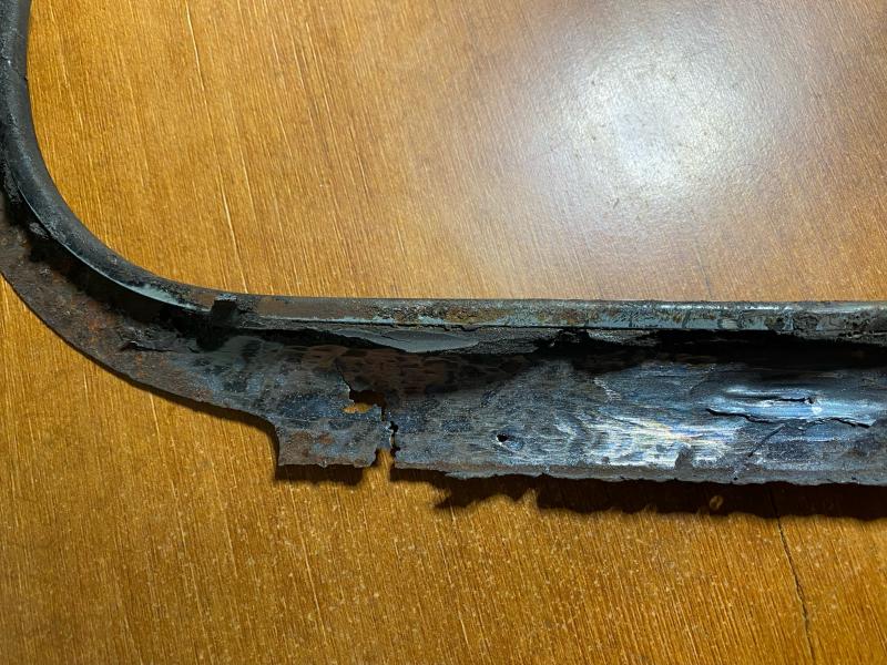

bsblguy 02-11-2023 11:57 AM
Just replacing the weatherstrip you would think that where the weatherstrip is glued is part of the roof as I did when I started to remove the rusted roof skin. The part where the weatherstrip slips into the groove is actually a separate part from the roof skin. There is the roof frame then this weatherstrip channel then the roof skin all spot welded together all the way around the opening. I have a piece of this channel at a sheet metal shop now to see if they can duplicate it. You can buy a replacement roof skin but does not come with the channel. I've been told that restoration shops have had to have it made or possibly they were able to save the one on the car. Mine was rusted and couldn't be saved. I was hoping that someone has had theirs replaced and maybe the shop had some extras made. And before anyone tells me to take it to a restoration shop to have the roof replaced don't bother as I do everything myself with the exception of special machine work. You can look at the roof panel on Ames site part #FH703G and see that there is no weatherstrip holding parts on it. I will try to post pictures later. Thanks again.

If you look at your picture you can see the lip that goes all the way around the opening where the weatherstrip tucks into. I see the parts in the corner that you are talking about but I'm talking about the part that goes all the way around the opening, That part is not part of the roof skin. Had I known that before I started to remove the roof skin I would have saved as much as I could and only had to replace a small section on each side. My next life I will not make as many mistakes.

bsblguy 02-12-2023 10:10 AM
3 Attachment(s)
My car had a lip that went all around the opening that the weatherstrip went in. This is at the open side of the opening not the back side. My car did not have the pieces in the corners to tuck the weatherstrip under. Who knows what the previous owner did. Most of what he did wasn't good. I have some pics on my phone and in downloads folder on my computer but haven't had any luck posting them. Looking at the pics Randy posted I do not see the lip but on W78's pic I can see it. Looking at that pic where the paint scraper is on the roof I can see the lip I am talking about. On my car that is not part of the roof and does not come with a new roof skin. I managed to remove part of the roof skin that lays on top of the part with that lip which that part lays on top of the roof frame and is all spot welded together. Once painted it all looks to be one piece and part of the roof. I have a couple pieces of the part I am talking about at a sheet metal shop I may go back there and pick up tomorrow. I may just glue the weatherstrip down and put those corner pieces in and save a lot of money.I think I managed to get the pics up and a drawing of what I am talking about.
bsblguy 02-12-2023 10:21 AM
The 2nd pic you can see a piece of what I am talking about with the roof skin removed and the weatherstrip channel still there. The new roof skin is is shown but not in position yet. The first pic you can see the frame and a section of the channel still there but croup up as I cut the spot welds that hold it to the frame. I do not have a piece of the channel separate to take a pic of as I took them to the sheet metal shop. When you say you cut an entire roof of before I assume that would be to replace an old rusty roof or to change to a t top roof. When I have seen that done they cut frame and all to be welded on another car. It's not the same as removing the roof skin to be replaced. I hope my drawing helps.

bsblguy 02-12-2023 10:54 AM
The lip in the 2nd pic is what I'm talking about. There is only about 5 inches or so that was not removed. With the headliner removed I think you might be able to see the spot welds where it is all welded together. It is a separate piece but doesn't look like it is until you take it all apart to replace the roof skin. I'll figure something out. Thanks for your help. I have had good results with soft seal products so will probably get those for the roof.

bsblguy 02-16-2023 10:34 PM
Attachment 607309
This is the weatherstrip channel that goes between the roof frame and the roof skin then is spot welded together. I have had no luck with sheet metal shops so I tried restoration shops. They said anywhere from several months to a year before they could make it. I bought some sheet metal and am making my own.

bsblguy 02-23-2023 09:58 AM
Home made weatherstrip channel in place and starting to weld the new roof skin in place. I bought a 240v spot welder and it is working pretty well.

bsblguy 11-25-2023 10:51 AM
I just used a piece of sheet metal and bent it to the shape I needed. The corners I had to cut the width so it would bend. I used a piece of extra exhaust pipe that I cut and bent to the shape I needed for the corners and bolted it to a table. The corners were the hardest part.
