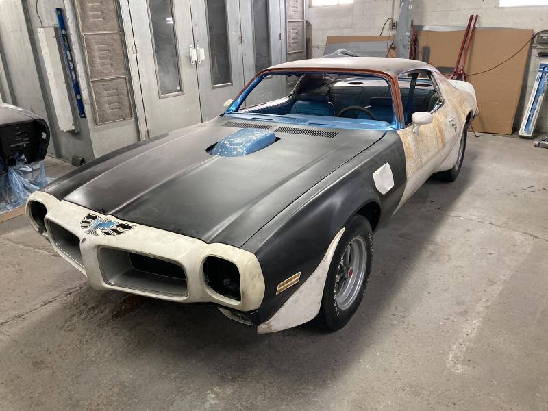

Tellyshavilli 12-20-2023 12:47 PM
2 Attachment(s)
1970-71 original paint
Tellyshavilli 12-20-2023 01:02 PM
2 Attachment(s)
Where’s the car ?

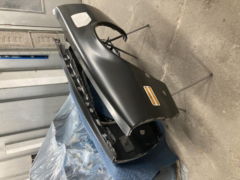

Poncho Dave 12-22-2023 09:33 PM
3 Attachment(s)
Changing the inner structure photos:
Attachment 625458
Attachment 625460
Attachment 625459
Red80TA 12-22-2023 10:33 PM
Another feature of 1972 non-TA front fenders would be the 2 pin holes for the small bird emblem #485929, that year only.
Tellyshavilli 12-22-2023 11:21 PM
Attachment 625458
Attachment 625460
Attachment 625459
Great work how many hours did you have into it?
necdb3 12-23-2023 08:17 AM
Attachment 625458
Attachment 625460
Attachment 625459
Exactly what I did. When finished, no one knows.
Poncho Dave 12-24-2023 10:41 PM
Remove inner structure from four fenders and weld one pair was approximately eight hours. Pretty sure that included sandblasting the pieces before welding as well.
