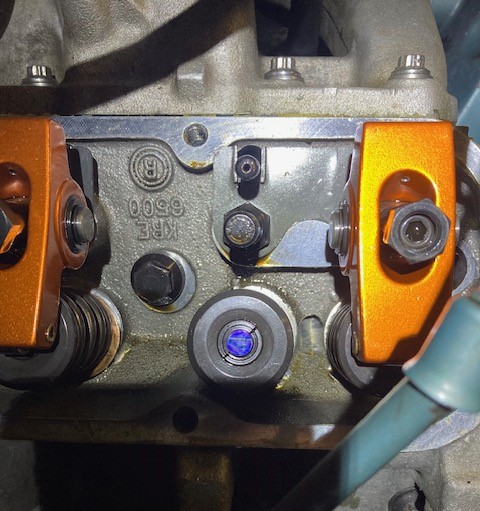

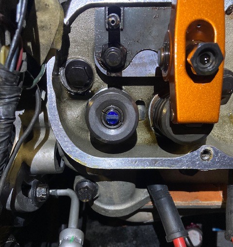

Check your pushrod length before doing anything else. They wont be the right length if the heads were swapped on and the original pushrods were used. Who assembled it?

ericwoo 05-16-2025 06:06 PM
Originally Posted by steve25 (Post 6564880)
So you did a cranking compression test with all the other plugs in?
If so then now you have to do that test again or make a leak down test before you say that removing the heads is needed.
Be sure to kill the power to the HEI before making these test.
Originally Posted by Jay S (Post 6564807)
At very least you need to do it again before make any conclusions.
I had a Pontiac that the factory deck machining height was off .018” between banks.
So I adjusted the valves again just to get the hydraulic lifters to zero lash, then tightened 3/4 turn. Then tested the compression a 2nd time with the below. Took all the spark plugs out and the engine warm. Overall, the readings seems to be similar +/- 5 psi. (not sure how precise my old gauge is)
Driver side head
# 1: 155 psi
# 3: 160 psi
# 5: 155 psi
# 7: 158 psi
Passenger side head
# 2: 195 psi
# 4: 194 psi
# 5: 200 psi
# 8: 187 psi
I am ordering a leak down tester to see if there is leakage in that driver side head. Hopefully I should get that complete early next week.
The next thing I realized, is the pushrods are indeed a little too short. See the test I did in the attached photos
Passenger Side
https://www.hyperleadit.com/wp-conte...enger-side.jpg
Driver Side
https://www.hyperleadit.com/wp-conte...river-side.jpg
