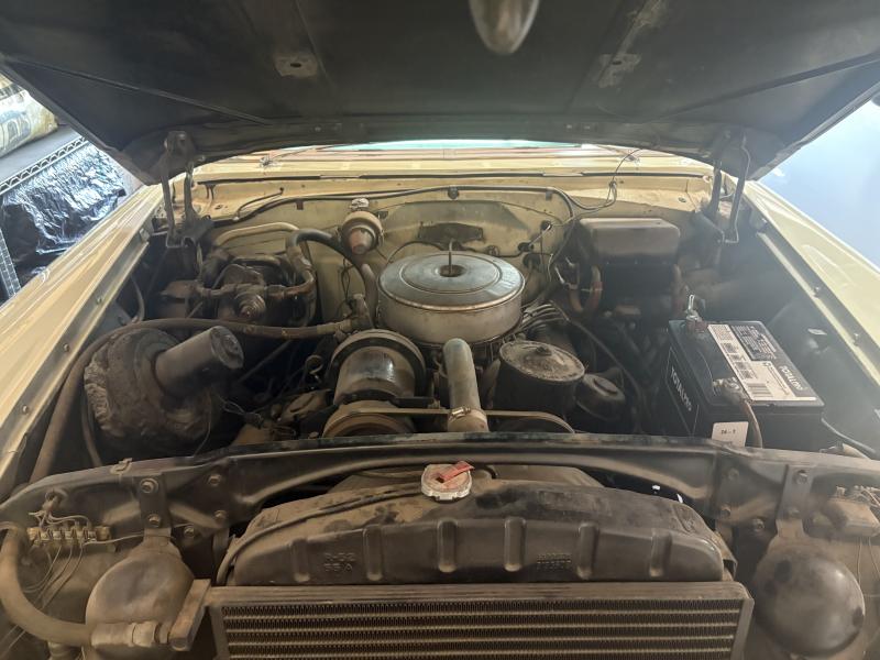

Great start! Pictures... Exterior shot, dash, under hood might be helpful and interesting. Good progress on electrical testing. Something to implant firmly in your mind, "NEGATIVE GROUND".
The Motorized antennae is an uncommon option and an indicator that there might be several options on the car. It is fortunate it is working. Radio not working is likely a bad tube. That can wait. Horn, radio, & lights work with ignition off. You can test directional signals and by turning the ignition on (doesn't need to be started).
For dashboard lights, turn headlight knob all the way to the right and see if they light up. For horn, press the horn ring. If it doesn't work, put it on your list of things to fix.
For removing the gas tank, you might find the first video linked by Sirrotica (thanks) to be helpful where he removes the tank. I watched most of the first video. It was long and addicting! Very interesting and helpful to someone putting an old Pontiac back on the road. I believe there are reproduction gas tanks available for your Star Chief. If there is a lot of rust in the tank, a replacement might be a good option.
Fuse box is under dash to left of steering column. Fuses are labeled.

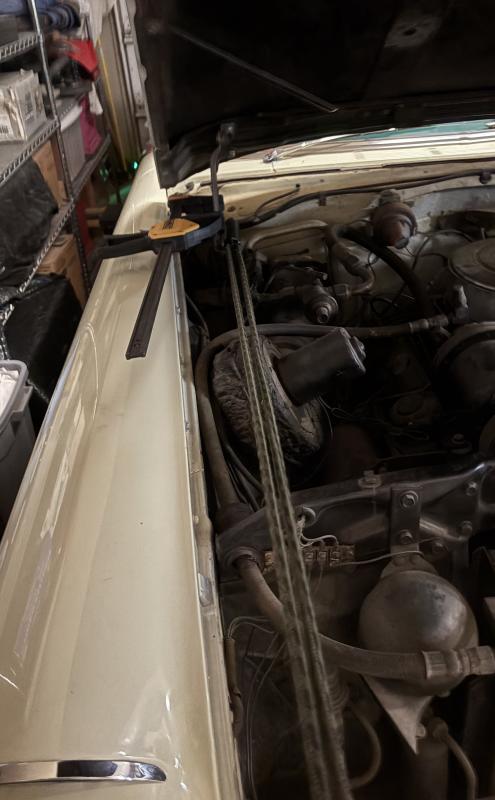

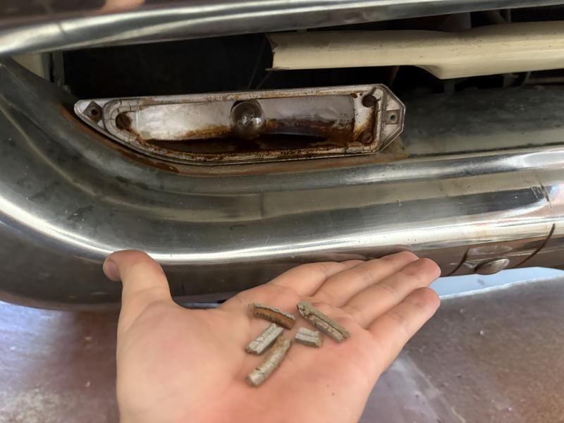

Parkman51 10-21-2025 10:41 PM
5 Attachment(s)

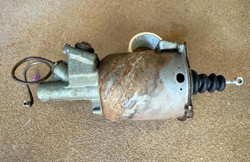

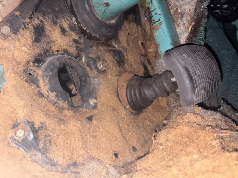

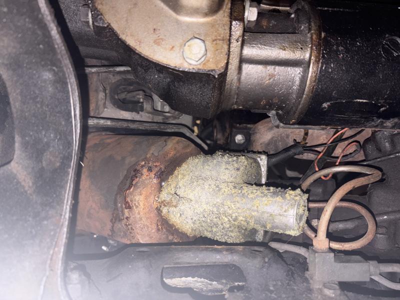

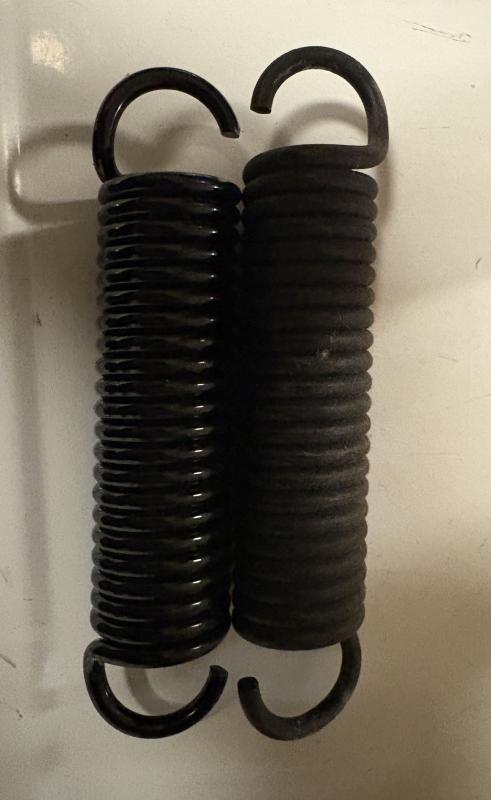

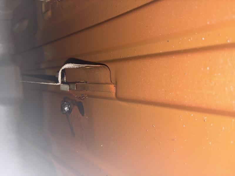

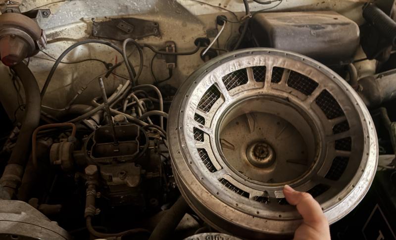

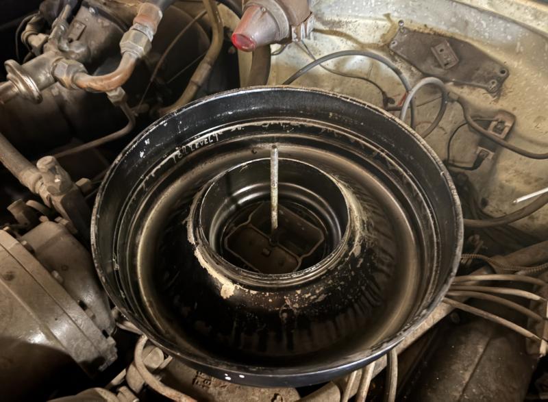

Alright, the fuel tank is removed and drained. That was an interesting bit of mechanical Tetris. It looks to be in remarkably good condition - I can't really see any rust.
No luck on the dash lights, but for the horn, I did find a disconnected wire on the junction block next to the driver's side horn. I highly suspect this to be the culprit but didn't get to reconnecting it today.
I've been having a lot of fun watching the video you linked, Sirrotica. My engine bay looks a lot fuller than theirs, I think due to a/c equipment, but you'll be able to tell better than I from the pictures.
Tomorrow I'll get a gallon or so of gas and rinse the tank, then re-drain it. The tank drain plug tries to leak, so I'll replace the plastic washer if I can find one. What should I do (if anything) to the fuel pump? I assume replacing the fuel filter is a given, but I haven't been inside a fuel pump before. Goatracer mentioned something about a 'sending unit' to be addressed while the tank was out, too. Also going to locate that fuse box (thanks for the tip, Larry) and replace any bad fuses - most are 7.5 amp, according to page 12-34 in the Shop Manual.Attachment 659111
Attachment 659112
Attachment 659113
Attachment 659115
Attachment 659116
OG68 10-22-2025 12:57 AM
Nice!
Bill Hanlon 10-22-2025 11:54 AM
Don't be surprised if the horn honks continuously (or intermittently when you turn the steering wheel) when you reconnect the wire. Disconnecting this wire is a "fix" for the wire's insulation rubbing off up inside the steering column and touching ground to activate the horn relay.

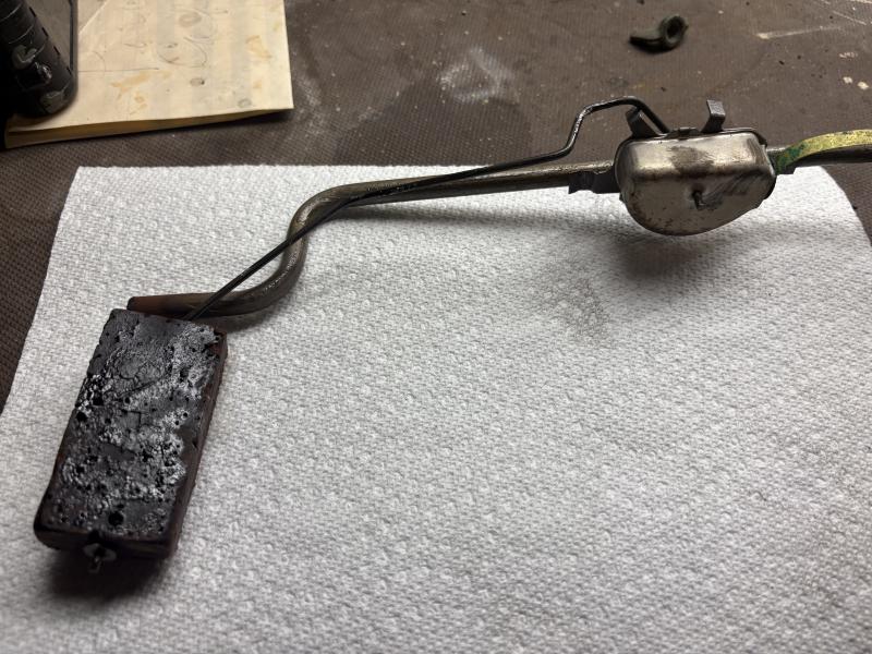

You can test the sending unit by removing it from the tank (most GM vehicles used 5 screws to hold it into the tank, Pontiac used the same gasket [GM part number 1516395] from 1935 thru at least 1960, my '57 GMC pickup used the same gasket ) and using an ohm meter to check from the post where the wire attaches to any metal on the attaching flange. Most GM vehicles of this vintage used 0 ohms empty, 30 ohms full. Attach the ohm meter and slowly move the float from empty (zero ohms) to full (30 ohms). The change in ohms reading should be linear. There shouldn't be any rapid changes in ohms or any readings much over 30 ohms.
Goatracer1 10-22-2025 10:15 PM
I was suggesting you check the filter on the fuel pickup. Some early ones were metal and are okay. If nylon replace it if bad. Boy you sound like you have a fully loaded car. Lucky!

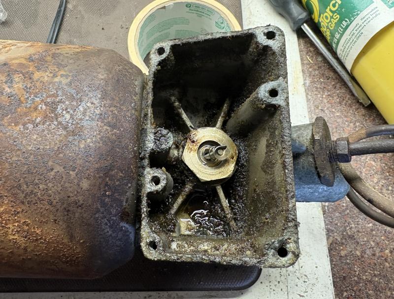

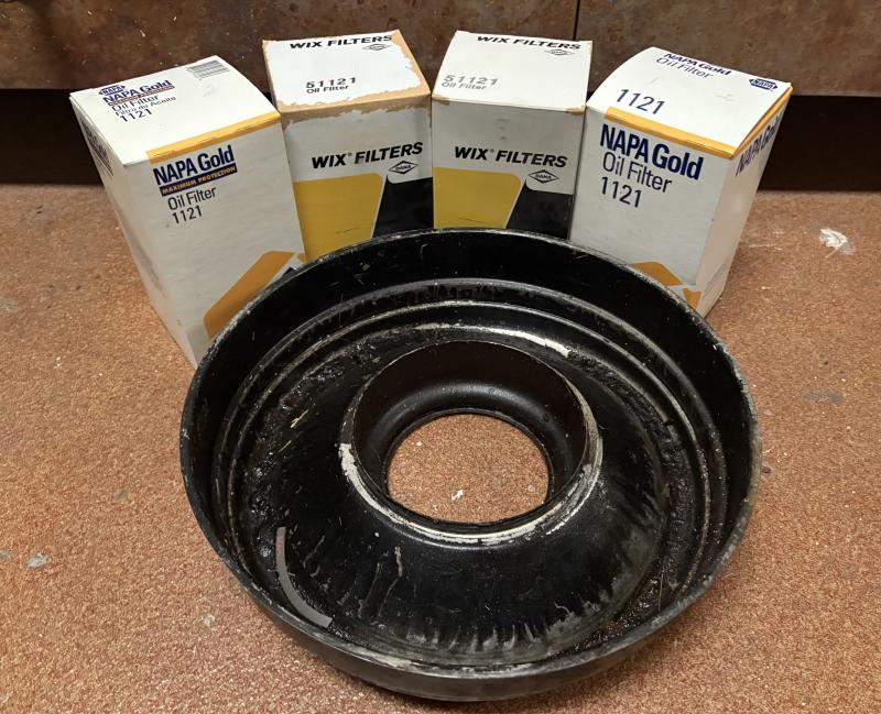

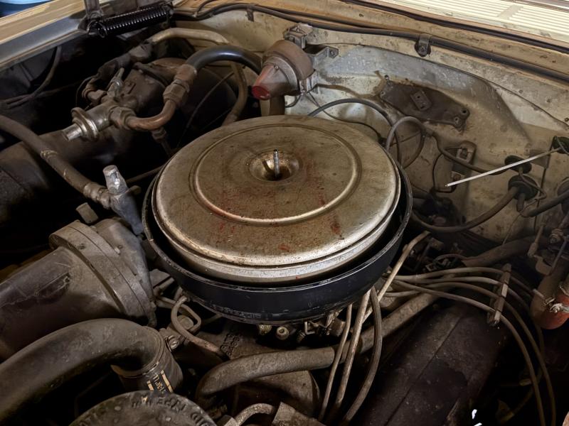

Parkman51 10-23-2025 12:38 AM
5 Attachment(s)

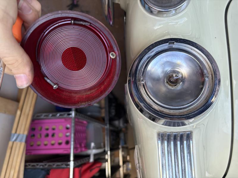

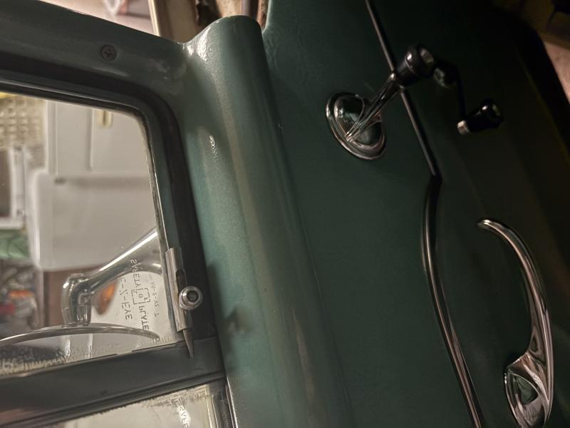

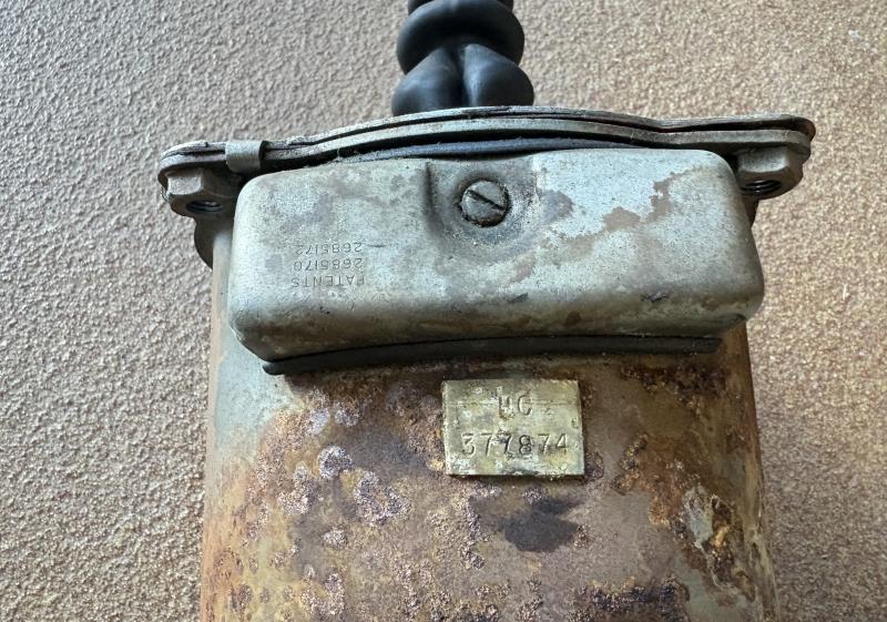

Nice big update for you today: After I posted last night I did a little cleaning: the door locks had been greased with something truly awful that rendered the manual lock pins black and sticky, and the windows didn’t roll as smoothly as they ought. So I worked over the rear door on the driver’s side – the others will follow as time permits. I removed the inside window trim, cleaned that, degreased the lock pin and its screw, then added some judicious WD-40 to the window (and door latch) mechanism. Also removed, cleaned, and reinstalled the metal strip that holds the carpet down at the door. I forgot to take before-and-after pictures, but I intend to remember in the future.
From Sirrotica’s video, also, I discovered that this car must have been fitted with the windshield wiper fluid canister, because there are capped-off lines running from the receptacle to the windshield. I shall have to see about getting that working, farther down the project list. Sirrotica’s video shows that the wiper fluid can be converted to run on the electric rather than the vacuum system, so that’s another thing to look at. It looks like CPR offers a bunch of parts for either system.
Today, I checked the indicators – all worked except the front passenger one, which is odd because that light illuminates correctly when the parking lights are on. This was a perfect excuse however to open up the front indicators to see what was going on – the gaskets were bad on both, but so seriously decayed on the passenger side that there was rust inside the housing. Two of the screws were rusted fast and only yielded to serious persuasion – but I ran to the hardware store and got replacements. I also checked the rear indicators, to see what they looked like, and found two more dessicated gaskets (before and after photos below). Finally, the glass covers for the reversing lights are loose in their fittings. So I ordered all 3 types of gasket from Ames.
And the horn! Bill Hanlon is a prophet. When I connected that wire, the horn worked so well it wouldn't turn off! My initial guess was a faulty spring or switch in the steering column, but rubbed-off insulation certainly qualifies. That will go on the list for a later project, but I assume the only way to rewire that without taking the whole harness apart is to somehow tie a new wire to the old wire and pull it through.
Lastly, I cleaned the outside of the gas tank with water and some degreaser, and sloshed some new gas around the inside, then redrained. Pulled the sending unit to see what was going on, and picture below, let me know what you think. The fuel line was totally plugged at the tank end – a good inch or so of semisolid molasses. After removing that, I could blow through the line no problem. Below you will also see a picture of the tank’s interior, I’m not sure what that odd block is in the middle of the tank floor. Another big thank-you to Bill Hanlon, who not only tells me how I can test the float, but gives me the part number for the new gasket I need!
Attachment 659166 Attachment 659167 Attachment 659168 Attachment 659169 Attachment 659170
Edit: It seems the forum decides - totally at random - in which orientation it wants to display my pictures. How do I rotate them to be right-side up?
Bill Hanlon 10-23-2025 11:02 AM

As you can see from last night’s photo, I found no fuel pickup filter on the sending unit (probably why the line was clogged). Regrettably, when I tested the resistance on the gauge, it mostly read 55 ohms, and didn’t change substantially when I exercised the float. So that means - new sending unit.
Two questions today:
1: This unit I found online looks as close as can be, even though it says it's for the Safari https://www.ebay.com/itm/405105617578 - give me a sanity check here, does it look good to you?
2: I took off the engine air intake to look at the carburetor, and lo-and-behold, I suspect I'm missing a part here. Seems to me there should be a riser or a fitting or something to bridge the gap between the top of the carburetor and the filter housing. What am I missing?

Safari Larry 10-24-2025 09:13 AM
1. No, Safari sending unit is not the same. CPR has one listed on ebay and it says "last one". Grab it.
2. You are missing the lower part of the air cleaner that fits over the carb and holds the oil. I don't see any listed on ebay for 4-barrel now but one is listed for 2-barrel. You can look at it to get an idea of what it looks like. https://www.ebay.com/itm/17715844955...Bk9SR9S1kuPCZg
You might try the "1955 1956 Pontiac" Facebook group and ask if anyone has one to sell. It will probably show up on ebay at some time.
Your Star Chief was a great find. Appears to be very original and in great condition. Lots of interesting options, including AC! I see very little rust. Has it been in a dry climate?

2. Air Cleaner. I believe the first one you linked is missing the top portion, with the silencer. The second one you linked has the top part with silencer, that tank hanging off to the side. That's what you need, however it is for 57, not 55-56. I don't know what the difference is, but the Master Parts Catalog lists one part for 55-56 and another for 57. I'm attaching a couple of photos of what your engine compartment should look like, including the large air cleaner.
The engine photos are of Rich Gabrielson's POCI National award winning 55 Safari. Engine compartment and front end will be same as your Star Chief. It appears you have the same options, including AC. I think you should still be able to view photos of his Safari at
https://bringatrailer.com/listing/19...star-chief-11/
Rich is a good friend, but he doesn't participate in this forum. He does participate and answer questions in the "1955 1956 Pontiac" Facebook group. He has three '55 Pontiacs, two Safaris and a 2-dr sedan with 389 ci engine.

3 Attachment(s)
Here's a question for you:
What's better than finding the right part on eBay for only $225, and arrival by Wednesday?
If you guessed "the previous owner finding the missing part, throwing in FOUR spare oil filters, and picking all that up for FREE on the way home from work," you'd be correct!
Photos below: It looks like it all fits together pretty well - though it doesn't have the silencer, it seems that may not be necessary - the '55 from Sirrotica's video doesn't have the silencer either, and it now visually matches the one on Ebay listed as a 55-56. I'm still not entirely sure how an oil bath air cleaner works, but I am resolved not to complain about good fortune.

Safari Larry 10-26-2025 09:46 AM
For your better way of getting parts, your chances are better at winning a billion dollar lottery!:rolleyes:
Photos of air cleaner will work as shown. The top part with silencer is not required for proper air cleaning. However, if you aren't concerned with original appearance, you might get a small after-market paper air cleaner, which will make for less mess, and will make carb easier to access without removing the air cleaner. For originality, keep an eye out for the top portion with silencer. A bracket that attaches to outer end of silencer and to head bolt is also needed.
The '55 from Sirrotica's video doesn't have the silencer, but it is the "standard" 2-barrel carb. From what I'm seeing in the MPC, Group 3.402, only the "heavy duty" air cleaner with silencer was used for 4-barrel carb. The 4-barrel carb was not available until the "power pack" option was released, mid-year '55.
Question 1. How does air cleaner work? See Shop Manual, p. 6B-2. For air cleaner maintenance, see p. 0-5. Use engine oil.
Question 2. Use the green IAT antifreeze at 50/50 ratio with water. Distilled water is best. Additional additives not needed. For details, see https://www.hemmings.com/stories/tec...of-antifreeze/

Rachelsdad 10-27-2025 12:55 PM
Quick one, as I didn't see any follow-up:
Those "front windows which open radially" are vent windows. What is particularly interesting about this era is the locking capability which disappeared when these gained cranks by the end of the decade. Hopefully, your locks still slide freely, and you have the vents opening and closing smoothly. The vent window is one innovation which has been lost to history, yet sorely missed by many of us.

Parkman51 10-28-2025 03:50 AM
3 Attachment(s)
Ah, vent windows. That's a good name for them. And yes, enjoy a picture - they have both the cute little pin locks and a crank. Today I dropped by a local auto store and picked up some engine oil and antifreeze (I assume it takes about 4 gallons of 50/50), only to find out when I got home that I can get the antifreeze for less than half the price online. So a-returning I shall go. Also removed the short bridge line that connects the metal fuel line to the fuel pump - some varnish and some pellets of petrified petroleum poured out. Better out than in!

Today's two big questions, however, have to do with the brakes.
1. While I wait for all my other parts to start trickling in, it's time to finally excavate the master/booster cylinder from its nigh-impenetrable refuge. I think the only way to accomplish this is to go in from the driver's position, by removing the plate behind the brake pedal, and pulling the whole assembly through into the cabin. Am I right, or is there a better way to do it? Photos below - I think it's a Delco-Moraine unit.
Attachment 659533 Attachment 659534
2. I will definitely reach out to White Post - after all, 'if you think hiring a professional is expensive, wait 'til you hire an amateur.' Anyone else I should get bids from? Ideally, I'd like to have it back in a month or so, though I expect the good folks are probably backlogged.
That's the only way to do it (AFAIK). It was a bizarrely new experience for me, having worked on several things - but from 1963 on up. This is a completely different animal. Now, assuming you do have power brakes (based on the other options, I'd expect so), the booster and master in a TreadleVac unit are one assembly, and you will find the vacuum storage tank mounted separately, forward on the left hand side under the hood. You'll want to check that for its ability to still maintain vacuum (on my '56 Safari, an earlier owner decided to "fix" the broken weld at the top where the tube exits the canister by using silicone rubber...don't ask). White Post also fixed up my vacuum canister, by welding the tube back where it belonged, glass beading the entire thing, and repainting.
I don't have another recommendation for you for the master cylinder/booster rebuild. On my '63, we replaced the master this time around (a few years back, and I still have returned parts in boxes) with a rebuilt one from Ames. If no core return, I'll have White Post rebuild my old one to keep on the shelf. Which reminds me...
While you are working on the brakes, take a few minutes to get under the car and inspect the brake lines. I've had much younger steel lines than yours rust through. Assuming they look solid, you might still consider replacing them with pre-bent stainless steel ones (and of course, the rubber lines at the wheel cylinders should be inspected and replaced as necessary. When your master comes back, bleeding and testing for frozen wheel cylinders will be another fun excursion, but at least hydraulic brakes are all very logical in that respect.
Last note about vent windows and my earlier mention of cranks: Early-early vents (and still later, those in less expensive cars) had vents which simply "pushed out." So, unlatch the lock, push to the desired position, and done. The bottom of the vent had a little knob to pull it back into place for locking, usually integral with the lock. The cranks overlapped for a time, I guess until someone at the factory (or in sales) decided that people felt sure enough that when closed without a lock, the vent couldn't be breached from the outside to gain access to an otherwise locked car. It's funny how some stuff just hangs around for a while.

Instructions for removing power brake unit are given in Shop Manual section 5, p. 5-20. Listen to those with experience (I've never removed one). For recommended shop to rebuild, you might try asking in the 1955 1956 Pontiac Facebook group. If you are looking for a local shop, give your location.

Parkman51 10-28-2025 10:07 PM
4 Attachment(s)
It worked!
Attachment 659601 Attachment 659602 Attachment 659603 Attachment 659604
Today's two questions:
1: How do I test the vacuum tank?
2: I've looked at the shop manual, but it's just not making sense: how do I drain the coolant? Shop manual says there are 3 drain cocks - one on the radiator lower tank and two on the engine block - but when I poke my nose under the front all I see is a mystery-maze of metal. I see nothing I can identify as a 'lower tank,' - the radiator lower hose seems to go to the engine - and I'm not sure where on the engine to look, either. There's a round hole (6" or so) in one of the metal plates under the car, through which I can see two bolts, but those don't look like 'drain cocks' to me.
Safari Larry 10-29-2025 11:05 AM
2 Attachment(s)
Externally, the power brake unit looks quite good for a 70 year old unit.
1. Not sure about testing, other ideas welcomed. If the vacuum tank looks in good condition, you might just assume it is okay. To test it, you might submit it in water, apply air pressure to the inlet, and look for bubbles.
2. See attached. The radiator shown is for 1955-56 non-AC, but I'm not sure about AC radiator, they have some differences. I would expect it to be in the same general location on front side of lower tank. For the engine drain cocks, you need to access them from under the car. The one on driver's side might be a bit difficult to access because of exhaust system and starter on that side. But it will be in same position as shown in photo on passenger's side. Be careful when opening drain cock from under car, don't get it in your eyes.
Bill Hanlon 10-29-2025 12:19 PM
I made a tool out of a 6" (more or less) long piece of 1/2" PVC pipe with notches cut in one end to fit the "wings" on the drain cocks. Helps in tight spaces.
