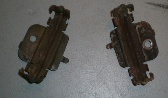

I think my car came with the four core lower brackets. It is a 68 GTO w/AC and a TH400. I attached a photo of them before I cleaned them up when I replaced my radiator. I couldn't find replacement isolators so I had to reuse mine. They are different from what everyone seems to sell - I bought 3 sets from 3 different vendors :rolleyes: and none match what came out of the car.

Check the remarks in both the Ames and PY on-line catalogs where the RR is listed. They both clearly state you need the 4 core brackets and trimming the insulators may be required. Both places sell brackets and insulators.
