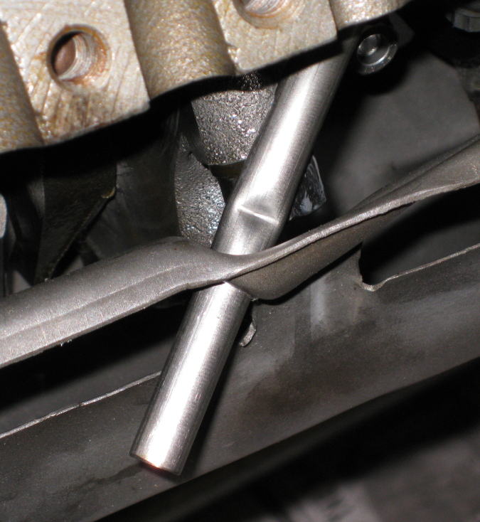

Great thread, lots of useful info here. I'm still confused about how to install my dipstick tube pieces, however. Hopefully you can help with the myriad questions below:
I have GME157 (upper) and GME157B (lower) for use on a non-A/C 400 with windage tray. I got these pieces from KRE, but they look identical to your pictures.
On my upper tube, the expanded part of the tube (at the very top) appears to be far too large to fit through the hole in the block. Is this tube necessarily supposed to be inserted from the inside of the block? Should it have been done before I put the main caps on?
I installed the lower tube into the hole in the windage tray, so that the kink in the tube is between the block and the windage tray. Is this correct? In this position, the lower tube is about half-way into the hole in the block, leaving half of the hole for the upper tube.

johnsma22 02-24-2008 12:56 AM
The expanded part of the upper tube is not the top of the tube where the dipstick rests, but rather, the expanded part of the upper tube is what friction fits into the hole in the block. You insert the smaller end of the upper tube into the block from the inside until the expanded part gets to the hole. It will then wedge into the hole in the block.
You have to make sure that the bend in the upper tube is oriented correctly so as to not interfere with your manifolds or headers. Once the upper tube is installed in the hole in the block, the lower tube will insert into it. I'm not exactly sure how the lower tubes for use with a windage tray mount, as I've only installed the type of lower tube that bolts to the main cap. I've heard that the type used with windage trays can fall out, but I'm not sure about that.
Maybe someone with experience with those will chime in. Also, I thought I read somewhere that the type for use without windage trays can be modified for use with a windage tray so that it can be better secured by mounting it to the main cap. Again, I'm not sure about that. I'm sure that someone will chime in with some experience on that.
TransAMrit 02-24-2008 01:29 PM
Oh, I see now, thanks... I'll give that a shot then, installing from the inside of the block. Guess I should have done this before the main caps went on - doh!
About the lower tube - I'm actually not worried about it falling out. It looks like the kink in the tube is just a little too big to let the tube fall out through the hole in the windage tray. Image attached.

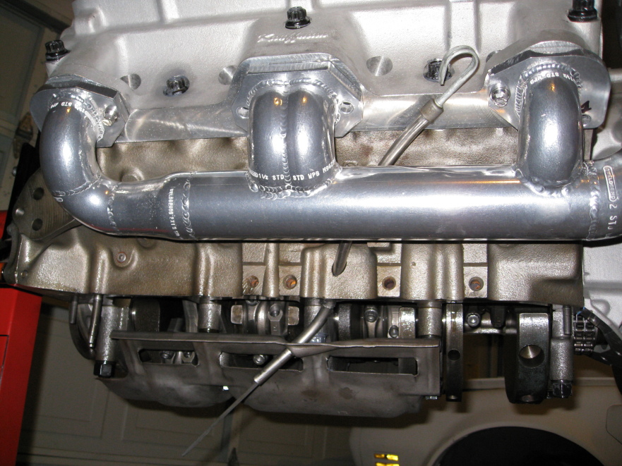

TransAMrit 02-25-2008 01:32 AM
For the record, that worked perfectly. It took a little convincing (read: hammer) because my main studs were getting in the way, but it's all put together now. Thanks!
Attachment 123668
johnsma22 02-25-2008 01:40 AM

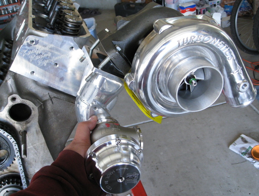

My pleasure! I'm glad I could help and that everything worked out. Nice looking setup, BTW. What's with that custom header? Turbo?
TransAMrit 02-25-2008 12:11 PM
Yes sir, that's a turbo manifold made by Paul Johnson of turbopontiacs.com, who's on this forum as 455Turbo. He did a great job with them, if you ask me.
Here's sort of a mockup of how the turbo will go on...
Attachment 123704
Redta 02-25-2008 01:40 PM
TransAMrit,
That's a sweet setup! Which KRE heads do you have there? I'm running the 85cc D-ports on mine. I had them ported locally to flow 300cfm. I've always been interested in turbos, but I don't know enough about forcing that kind of air through a carb.
TransAMrit 02-25-2008 03:16 PM
Thanks Redta! I'm also using the KRE 85cc D-port heads. I wanted to look into the high port heads, but at the time I ordered them, they did not have the large CC high ports (only 56cc or so). They're not ported at all, as it's supposed to not be as much of an issue when you're forcing air through them.
If you're interested in turbos, pick up Maximum Boost, by Corky Bell. It's incredibly informative about turbos and anything related to them. He has a chapter on turbocharging w/ carburetors, and another about turbocharging w/ EFI. I'll be going the latter route, with a Super Victor EFI manifold & MegaSquirt.
