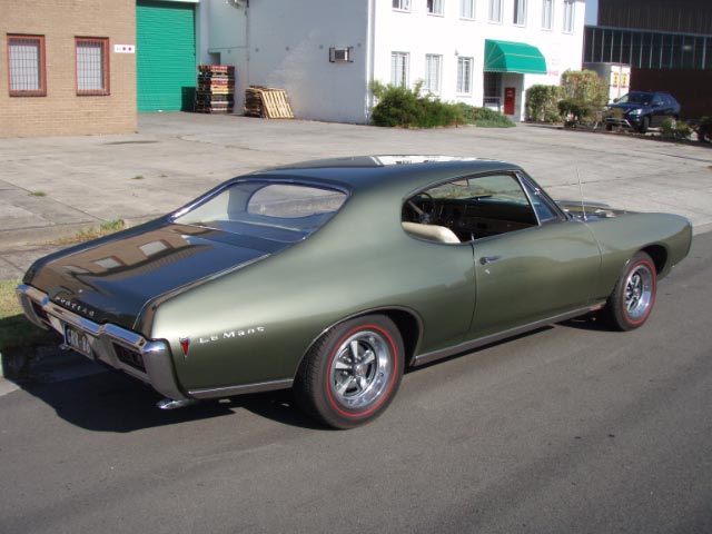

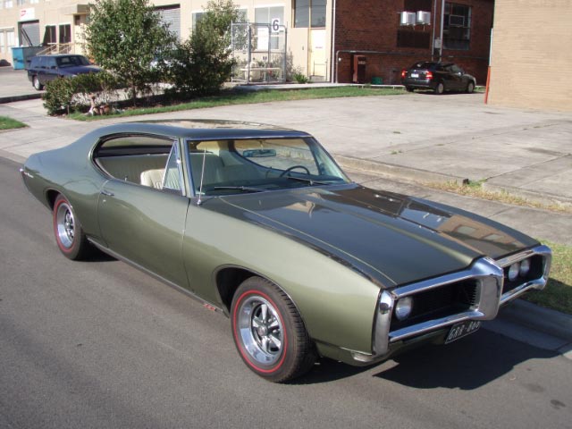

marauder 03-01-2009 01:15 PM
3 Attachment(s)
When I purchased my car it had 235/60x15s all around. I later wanted a little more rubber in the rear and went with the 295/50x15s. These are 15x8x4.5 Rally II repros in the pics and all with the 235s.
