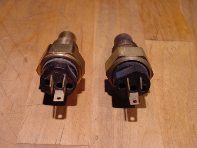

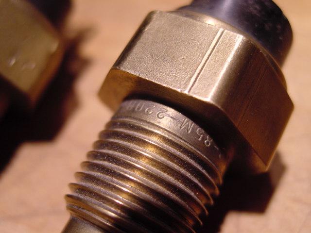

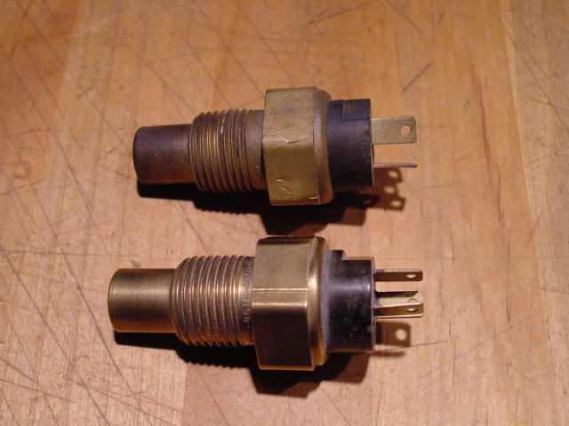

TA455HO 11-29-2010 10:45 PM
3 Attachment(s)
As promised here are pictures of the two sensors I have. I'm not sure when I got these, where they came from, how much I paid or what part numbers they are.
I do not have GM boxes for these.
Each one has markings just above the threads.
The NOS one is visually perfect. Markings read AC-85M-220B-253M. Asking $95 shipped to any continental US address.
The used one has some light wrench rash. Markings read AC-95M-230B-253M. Asking $25 shipped to any continental US address.

666 the legend 11-29-2010 11:42 PM
.well..?? Visually it looks to be correct..I sent you a PM...
666 the legend 11-29-2010 11:50 PM
I cant seem to find an old AC part#'s on the NET..though..anyone have a link or somethin..??

The three prong unit is the TCS sender that is on the pass side head. It is not designed or calibrated for the gauge and I doubt it will read correctly since it pretty much functions as a temperature-dependant on-off switch for the TCS system.
