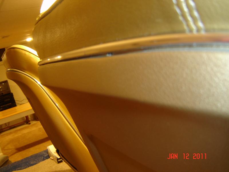

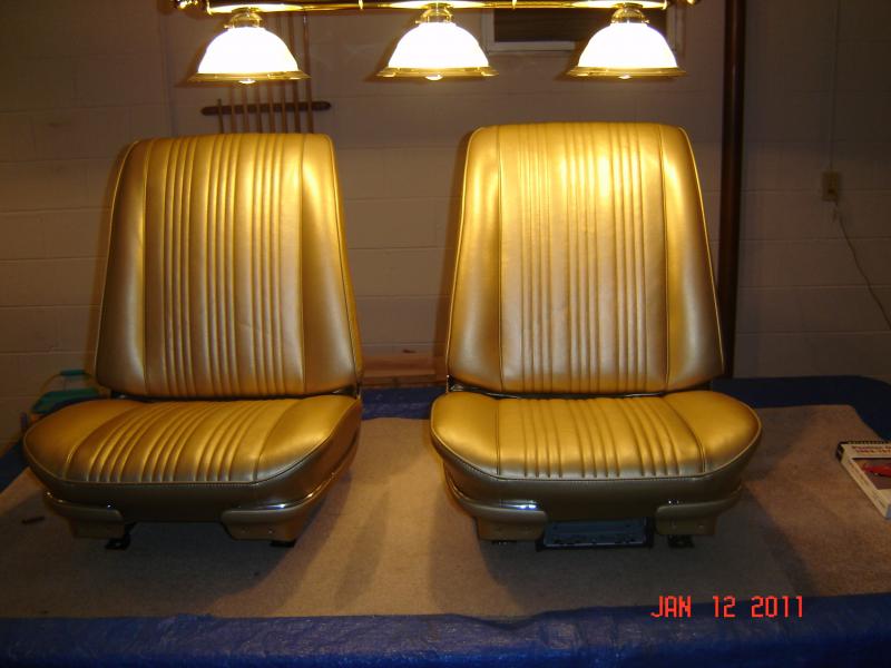

I just had mine done last year, and they turned out great. When I first sat on them in the car, my head touched the head liner, sh$#. But after sitting on them they went down just enough that now they are perfect, but they never looked like yours. My upholstery guy did a great job, the thing he was most insistant about is replacing springs evenly. The side springs aren't as big a deal as the ones you sit on, he said that those should all be replaced with new ones or if some are bad and need to be replaced to replace them with ones from a donor seat that have the same spring tension and diameter. And what ever is done to one bucket should be done to the other one otherwise you will feel the difference in the way each one feels. I used aci (american cusion industries) pads and mine turned out great. I just looked at mine folded forward and they don't look anything like yours the way you can see those springs, I agree with everyone else that something isn't right. Here are some pics of mine.
Attachment 277155
Attachment 277156
Attachment 277157

wow gomow, i wish my seats looked half as good as those.

Gomowgto,
Is that a radio housing under the seat on the right? If so how is it mounted? I would guess there are no clearance issues in all seat positions?
Thanks,
Dave
gomowgto 03-05-2012 06:57 PM
Yes it's a radio box, I guess you would call it. I bought the pioneer am/fm cd player at best buy, and out in the installation shop at most best buy stores they had that black box that the radio slides into and locks in place. It fits so tightly between the seat rails that it is just wedged in place and it has a lip on top that holds it up and inside the seat rails so it can't come down and touch the floor. NO clearanc issues when sitting on the seat and no issues with moving the seat back and forth. Now you would think that if I was able to figure that out that I could come up with some speakers for it?? NOOOOO. My 67 came with only one speaker center rear and one center front, and I just can't bring myself to cut holes in the rear package tray for two 4x8s and nowhere to put front speakers. I have considered the kickpanel speakers they sell for the front, but I still can't come up with a way to put two good size speakers in the rear without cutting holes. Any ideas or suggestions would be greatly appreciated as I have had this radio in for 5 yrs now and don't listen to it cos 2 speakers on a 4 speaker system sound like crap!
