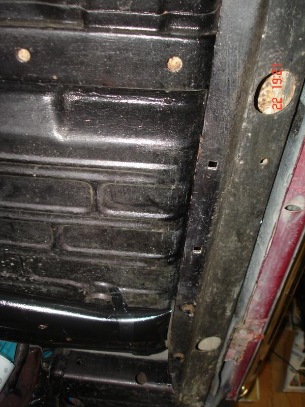

64gpnz 10-22-2012 04:57 AM
some photos
5 Attachment(s)
Attachment 301089
Attachment 301090
Attachment 301092
Attachment 301093
Attachment 301094
Firstly thank you both for your replies.
I brought this car over 25 years ago,It was the great dash and chrome gauges that made me want to buy it, previous owners to me had removed all running gear(350 chev last engine, originally 389), in fact someone gas cut the engine mounts from engine crossmember leaving two holes. So after soucing a 455 I han no exact knowledge of the correct engine placement. Being a factory 4 speed I purchased a m20 dropped it in the hole and mounted where it looked like it should go. Now I've replaced the 9" with an original item I imported from states and have replaced the park brake cables with proper ones & found crossmember to far foward.
I found a photo of an auto clearly showing cross member further aft, also took photos of my GP
I've circled the brake adjusting clevis which is right were crossmember is & possible x member mount holes
See what you think of these photos Cheers Richard

The square holes in the frame are where the carriage bolts went in the original cross- member location. This would have been used for a t-10 4 speed or the automatics.
The Pics of the E-brake cabling look right like on my '63. There are different fulcrum points where the thing can be adjusted. See where the clevis pin goes in and there are 3 holes. So if I understand your issue, that could be it. If the assembly is in a slot in the frame by the driver's door, then it is probably in the stock location as I don't see how it could be hooked up if it was not. It is not the greatest design with the cable under the x member. At least that is how I ran it b/c I did not want it neat the U-joint/drive shaft. Just gave me the creeps.

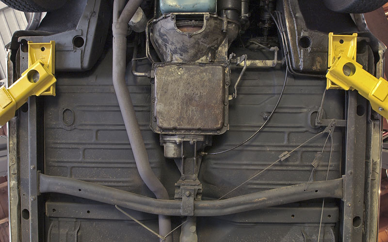

Jon(or anybody else) could you please show me a photo of your GP crossmember from slighly further back so I can see the brake cables & details of the intermediate lever.
Thanks Richard

Jon Wood 10-25-2012 09:05 PM
Richard,
Somebody moved your crossmember forward from the stock location - I think you mentioned there are square holes about 6 inches back. If you move your crossmember back to those holes, and use the correct transmission mount, your parking brake stuff should clear.
