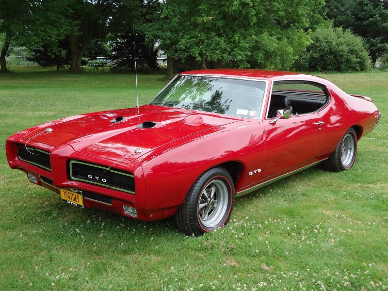

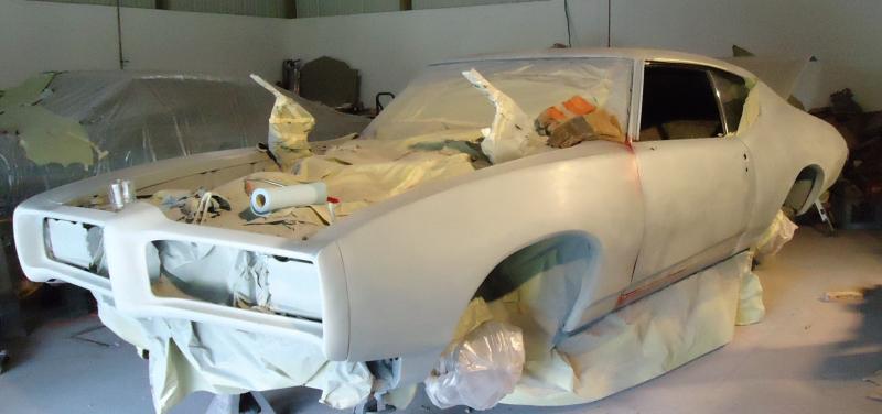

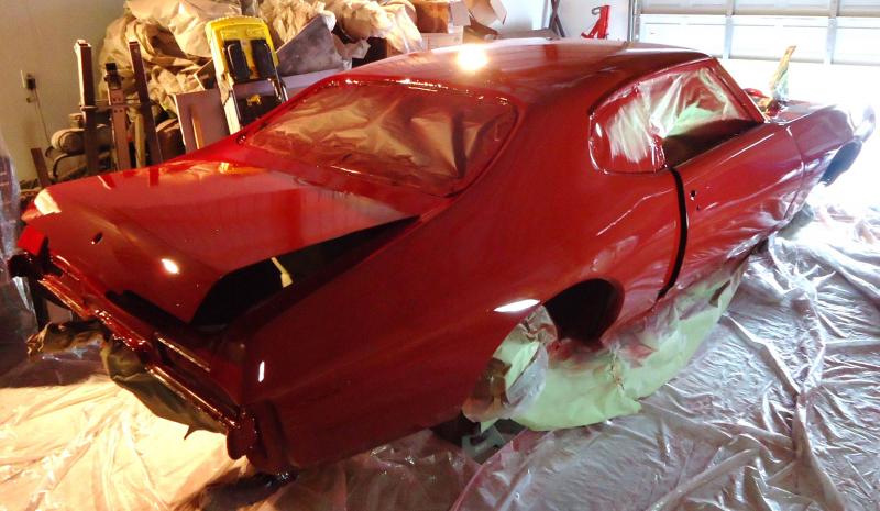

1969GTO 01-22-2013 11:09 AM
Garage Paint Job
5 Attachment(s)
:) just to give you some idea,mine was painted this past summer 2012 in my friends big garage.
He used several fans to push-pull air out,plactic covered every thing,all the lighting you can get.
The car came out great,base coat clear coat,Matador Red.
We still plan on having the car wet sanded and buffed. I'd like a little more shine:D
Have fun and take your time.
Attachment 310557
Attachment 310558
Attachment 310559
Attachment 310560
Attachment 310561
