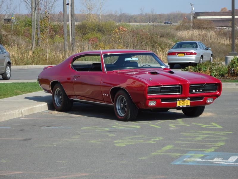

1969GTO 03-02-2013 12:08 PM
YOU SAID MAYBE STROKE IT
:jumping: I love my stroked 400/462:usa2::focus:Attachment 314914
