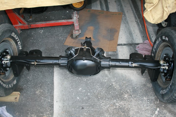

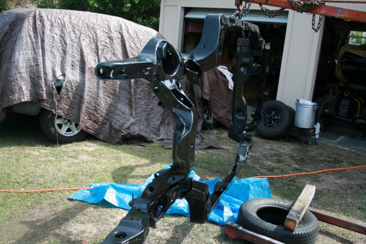

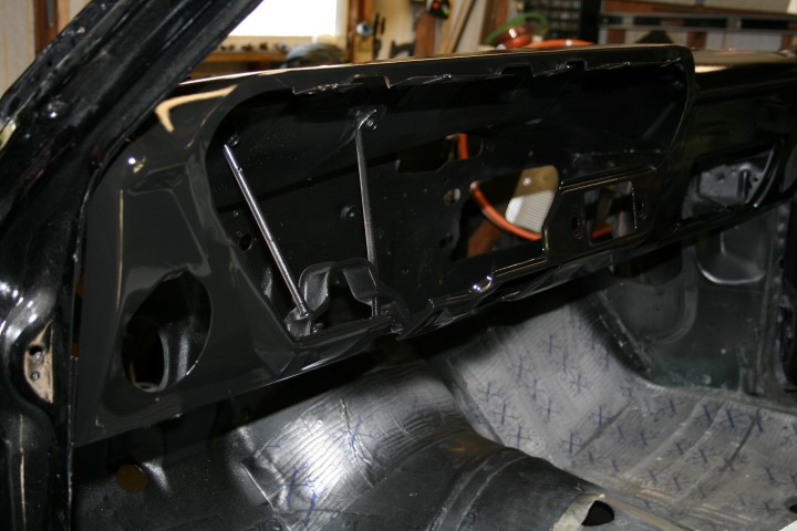

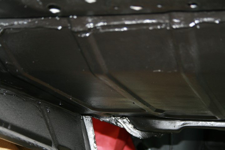

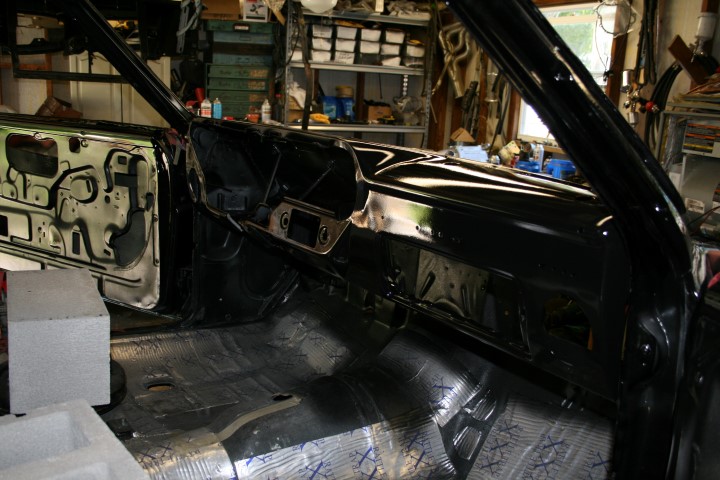

So the pieces are starting to come together I finally got one of the last pieces finished and it came out great for a back yard job blasted with HF 100lb unit ground and sanded until my arms fell off epoxy primer last night 3 coats chassis paint this morning hope to roll it under car Tues and get going on reassembling.Under body blasted and epoxy finished with 2 coats zerorust and top coat satin chassis black all new body mounts and correct bolts. Rear end went from a 2.93 posi to a 3.26 gear complete o/h longer wheel studs installed for disc conversion.Hope to make some noise soon just to get the adrenaline pumping again my father son project turned into just dad allot of work for this ol man yeah he bought a Mopar so he's on his own haha anyway just an update..thanks to all who chimed in not done yet.
Attachment 318215
Attachment 318216
Attachment 318217
Attachment 318218
Attachment 318219:old:

ITSBACK 04-04-2013 03:16 PM

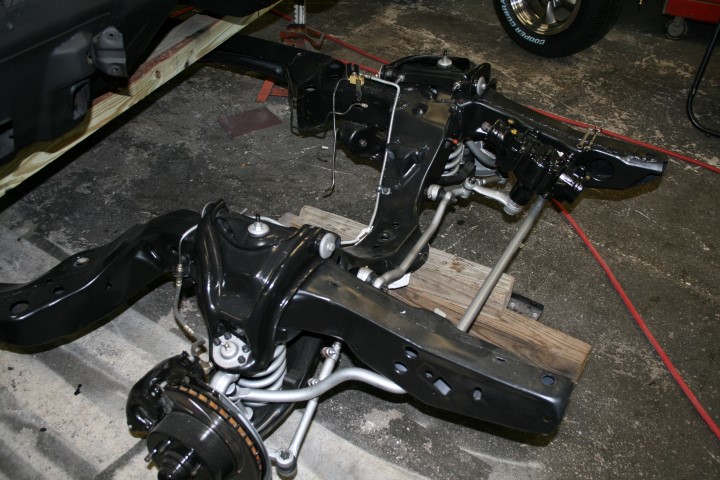

I like the idea of holding the frame in the air with engine hoist.
geeteeohguy 04-04-2013 03:30 PM
I like that too. It's a new one on me, and it makes sense. Lots of great ideas on this forum!

1966geeto 05-03-2013 05:06 PM
Some progress
5 Attachment(s)
Getting down to the bits and pieces good progress last week..

Would have the frame back down but brake lines holding me up :)

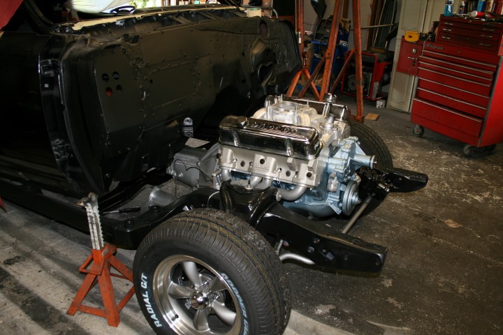

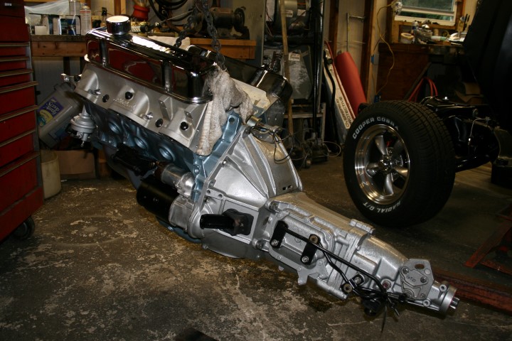

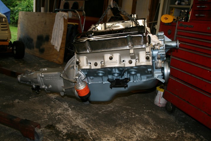

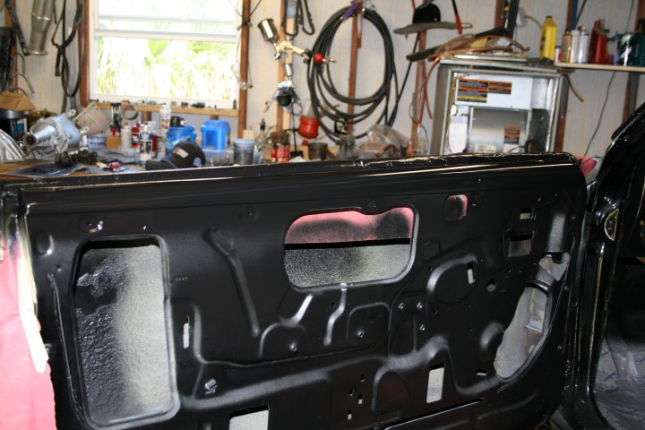

1966geeto 05-05-2013 03:36 PM
More bits and pieces..
5 Attachment(s)
One man band gotta get creative some more bits and pieces decide to re-shoot the interior and pieces did not like the way it came back from the body shop also Amazon hose in Tampa Fla solved my brake problem..Hope to drop drive train in Tues forgot to paint drive shaft..Thanks for all the positive comments.

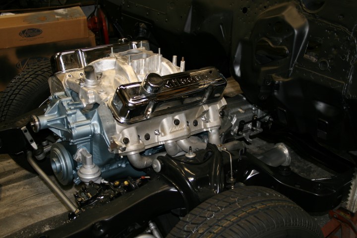

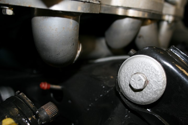

1966geeto 06-06-2013 03:52 PM
4 hours later
5 Attachment(s)
Attachment 325545
Attachment 325546
Attachment 325547
Attachment 325548
Attachment 325549

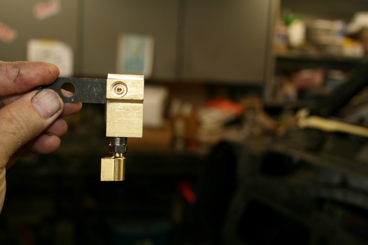

Some progress today dr header was a bitch by myself nothing to attatch the starter cable protector to guess I will fab one up.What do you guys think about brake line really close to header do you think it will boil the fluid.Getting there baby steps..
