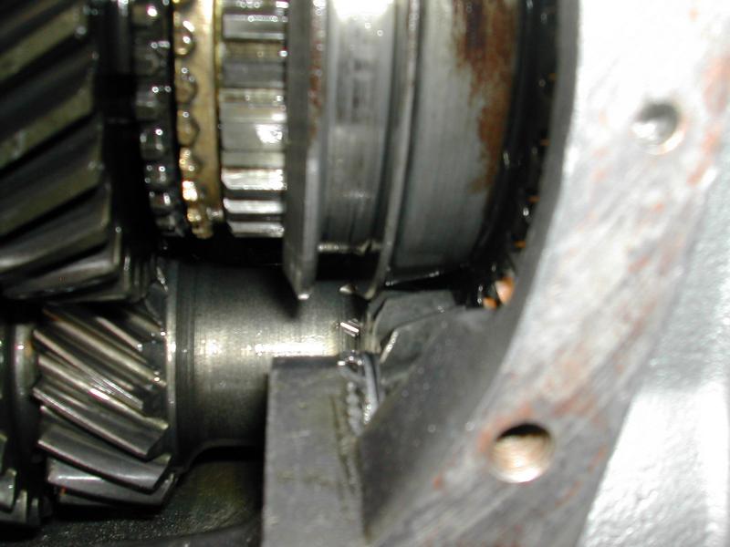

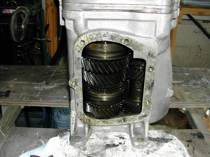

I have just rebuilt my Muncie m-21 from a '70 GTO and found a slight rubbing noise while accelerating in 1st gear. I was told that the front idler gear my be walking back and rubbing the 1st speed gear. I removed the trans and removed the side cover. The idler gear and 1st speed gear have plenty of clearance.
Attachment 326688
But what I did find was with the 1-2 slider pushed back It just touches the front idler gear.
Attachment 326687
The rear idler gear was replaced because the teeth were a bit chewed up. now if I put the old rear idler gear back in, the front gear and the slider clear by .001"-.002". I would think this is still not enough. There seems to be no end play in the idler gears to shim them back away from the slider.
Dose anyone know what I should be looking at to correct this?
Thanks, JT
Held for Ransom 06-16-2013 06:45 PM
Looks like your slider is installed backwards. I believe the bevel should face rearward on the 1-2 gears.

Bruce Meyer 06-16-2013 07:48 PM
Its backwards. Both sliders bevels face forward.

squidtone 06-16-2013 10:24 PM
JT,
I just got done today putting my Muncie M20 back together. (bad gears, got a whole new set of Autogear M22 "Rock crusher" wide ratio gears) Here are some things I learned while doing this whole job:
Your slider is correct. The bevels on the sliders face away from each other, so the 1st-2nd slider bevel faces toward the back.
Muncies are infamous for the reverse idler coming into contact with the slider when in first gear. Some folks actually make a larger bevel on each tooth on the reverse idler gear with a bench grinder. That may be drastic....
The rotation of the countergear should always tend to force the idler gear toward the back of the case. While you do have some endplay on that idler gear, is the reverse idler shaft able to seat all the way into the tail housing? Is there gunk in the shaft bore or roll pin slots preventing the shaft from moving back far enough for that extra few thousandths of clearance? If the shaft can go back a wee bit more, it may be enough for clearance.
the other thing that occurs to me is that maybe the slider doesn't have to move all the way against the helical teeth...it only needs to engage the engagement teeth...can you adjust your shifter stops (if you have them)?
Dave

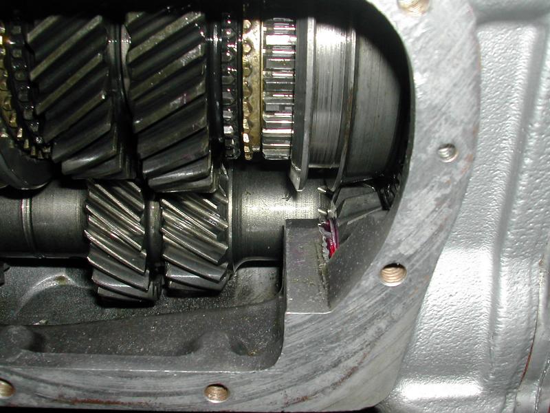

J.T. 06-18-2013 07:34 PM
I bit the bullet and cut the bevel a little more on the front idler gear. I would estimate I took off about .050". It looks much better.
Attachment 326907
Trans will go in next week. Can't wait for a test drive.
