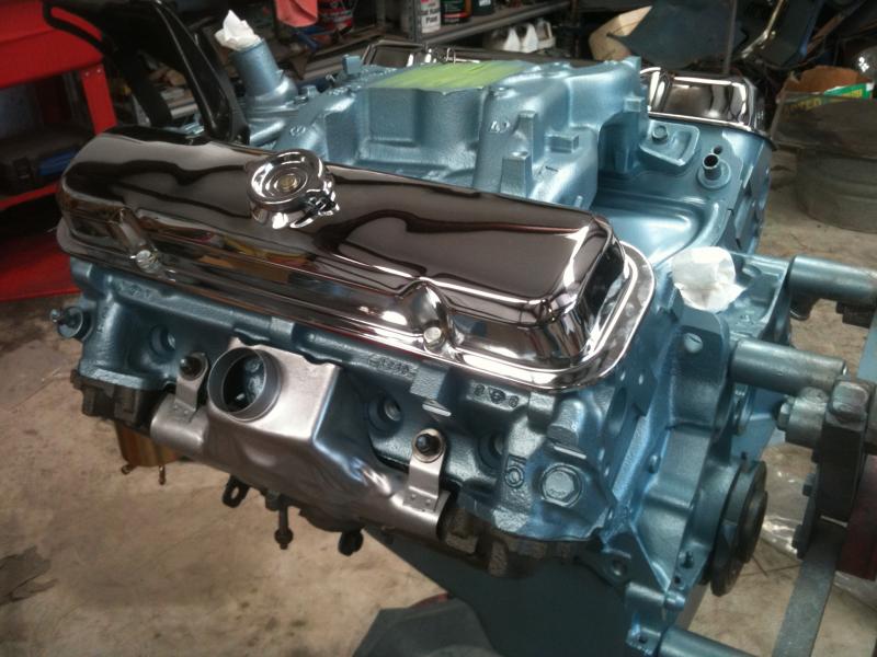

Pontiac Drive 08-13-2013 07:25 PM
More 70 4 speed restoration pictures
5 Attachment(s)
Chassis basically complete. Frame blasted and painted ( I like glossy) All suspension and brakes completely rebuilt. Engine completely overhauled. Used dished pistons to retain original # 13 heads. Compression is now 9.2 also installed 068 camshaft. Engine is original WX code 400. Original Muncie trans rebuilt. Original 3:31 12 bolt safe -t-trac rebuilt. Tires in pictures are only used to move chassis during build up. Will have original 14" rally II wheels when complete. Car was ordered November 69 and delivered Dec 69. Anyone know how I can I.D. how far along in 1970 4 speed production it may have been? Will post a short video of engine break in and test run soon. Starting on Body . Pics show changing top windshield header with a piece cut out of a parts car.
428ho4spd 08-13-2013 11:35 PM
WOW! You're doing a beautiful job. That's going to be one sweet GP when done.
428ho4spd 08-13-2013 11:38 PM
Please keep the photos coming through the process... love it!
2002Z4CSS 08-14-2013 08:01 AM
Nice work! :)
