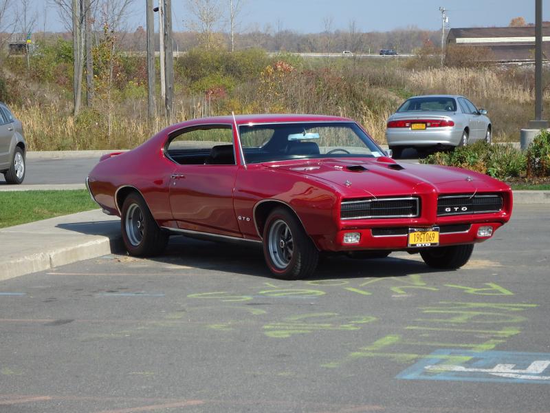

milage
Ten mpg :gag: 3.90 fun rear gears 27" tires.
I meet a lot of people at the gas stations :D
