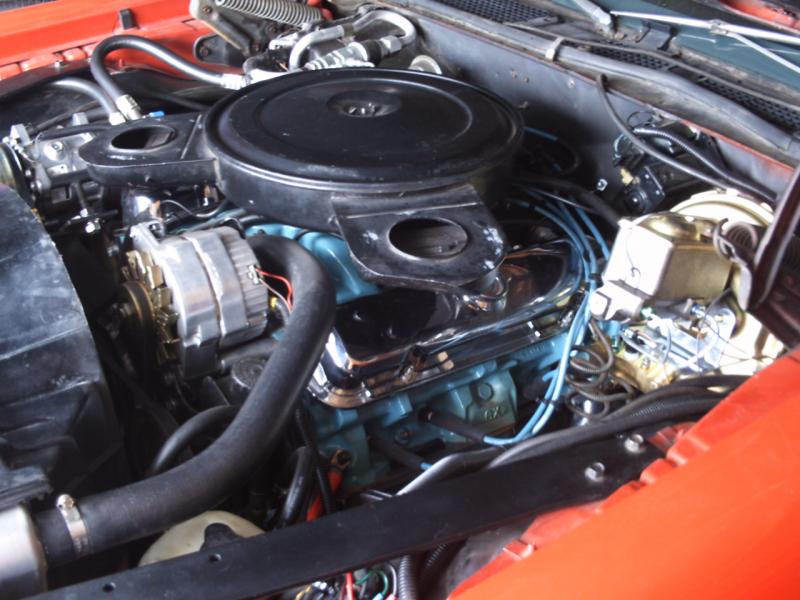

230 cfm @.500 6x-4 mill to 93 cc.. 72 Iron intake with Q jet. Dougs headers to 2 1/2 pipes to dynomax turbos. HEI. TH400 w/continental 13".. 3.08 gear.
A little attitude at idle but easy to drive around town.
Im still working on the front suspension and ride height so i have not been over 60 mph. But it don't take long to get there. :)
I'll be taking it to Bandimere for time trials once i get her dialed in and safe.
Attachment 363410
