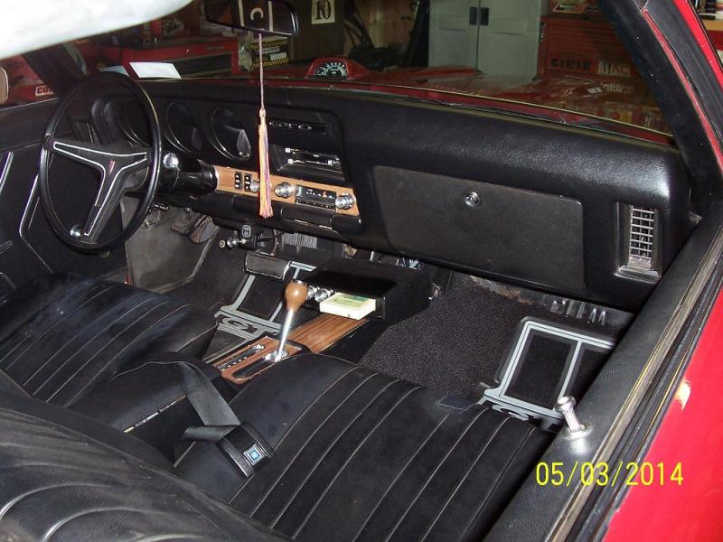

1969GTO 07-21-2014 08:23 PM
would the dash have open or switch deleet places on the dash? Like a radio deleet or my car also had in the dash next to the speedo pod a Clock/Tac deleet pod. I put a clock in that spot.
1969GTO 07-21-2014 08:30 PM
My 69 GTO Dash
2 Attachment(s)
Attachment 370863
Attachment 370864
I know,the carpet is cut short, it's new too, ACC junk:mad:
north 07-21-2014 10:01 PM
The wood panel had no sign of where the switches went, the metal dash frame had the three openings cut. When a dealer added an option he had a special die cutter, he drilled a starter hole and then used a two sided cutter that when the bolt on it was tightened it wood cut the wood grain panel neatly. 70-72 is similar but they only had two possible positions since the power antenna option was dropped.
