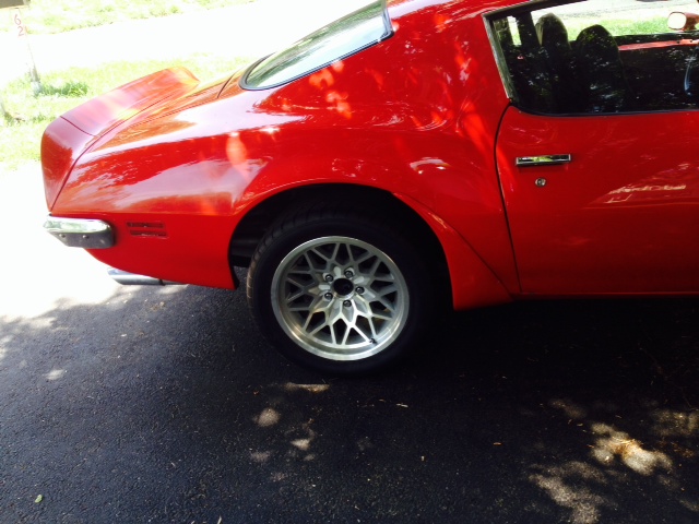

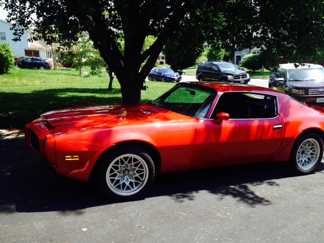

You can easily run a 275/60-15 on the back of a second gen, that's what I run on my 70 formula with plenty of room to spare. 28" tall and they still look smallish within the wheel well. You can dictate the tire height to work with your 3.73's to better suit the rpm range the car wants to run in. Usually pontiacs with torque don't need alot of rear gear so the 28" tire should be a good choice with your 3.73's. Your current tire is barely 26" tall and will make the 3.73's feel a bit steeper than they really are.

Yes sir, 275/60-15's MT drag radials that are 28" tall and roughly 9" tread width.
If you want something shorter a 275/50-15 is also made in a MT drag radial, these are 26" tall and closely match your current tire height. However they also are a tad wider (about an inch) than the 275/60's.

hdinch 09-04-2014 03:10 PM
2 Attachment(s)
Would like to go with these....if they clear
http://www.jegs.com/i/Mickey+Thompso...3754R/10002/-1
Attachment 375312
Attachment 375313
Couple of pics that show the car height with the current rims.
