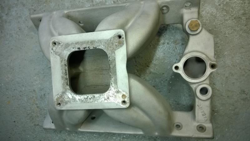

I can not search on the site, I just picked this manifold up, any info would be good, rpm range, pros and cons. Thanks
Attachment 397723

The Warrior manifold is essentially the old Doug Nash manifold. It's really more for racing verses street use. Tom S. and Tom Vaught probably need to chime in on this one.

PAUL K 05-14-2015 08:08 PM
Coolest looking manifold ever made for a Pontiac! IMO. However I don't think it will be the hot ticket for a boosted application, the plenum is to shallow and the boosted flow will not like snaking around the four inside runners.

Tom Vaught 05-15-2015 05:33 PM
Most of the fast racers that used the Doug Nash (or Warrior) single 4 intake at some point added plenum volume to the plenum. Either by cutting the bottom off and adding there or by a bunch of welding and runner raising along with the bottom modifications.
The intake needs about 40-50% more volume on a 455= engine vs the 366 engine the intake was designed for.

I have worked on a number of these and if the motor you will run this on is of 440 cid or larger and the heads have had the intake runner at the flange sized up to the RAiV gasket size and or the heads flow more than 260 cfm you will need to increase the runner expansion rate from what it is stock at the manifold flange all the way into the Plenum!
This is a ton of work if you want the most from this manifold and if you have the hood clearance and you are not heart set on this manifold a Victor would be far and away the thing to run!

Agree with the comments above. If you look at the development time line for this manifold, very few Pontiac engines were over 430 Ci In. The big engines were 421's and 428's were new engines. A great ported head in those days would flow 240-250 CFM @ 28" of water. Oh, how times have changed. It's a great manifold for it's day and great looking too. I would consider using on a hot 400 or a medium effort 421-428. For all the modifications needed to bring it up to today's head flow and performance potential, an All Pontiac, BOP, or Victor would be a much better manifold to start with as far as the work and time required. Before all this new stuff came out the Nash/Warrior manifold was highly prized.

Tom Vaught 05-16-2015 09:24 PM
You could probably get 10 times the value of the Nash intake if you could grind the manifold down to magnesium slivers (without catching the whole deal on fire).
The aluminum Warrior manifolds worked a lot better after being modded and welded on for the application.

The one you have is aluminum. The original Doug Nash was magnesium- rare

Tom Vaught 05-17-2015 08:05 AM
Agree, the "Warrior" name on the cross-over can be easily read.
A Intake like that could have a lot of potential as the runners were very good for the time and can be welded on and made even better. Deal is getting someone to weld a lot on the thing vs just buying a Victor Dominator intake for a few hundred $ makes more sense.
You bought a piece of Pontiac History, a point in time. Just like buying an old 1962 421 SD intake manifold. Cool to look at but not much good in today's performance game.
