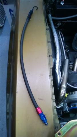

Here is my dipstick set up, I did make it shorter than the photo. I copied this idea from another person on another site.

PONTIAC LARRY 04-08-2016 09:12 AM
awesome sleeper I like it !
Curious George 04-08-2016 12:10 PM
I wanted to use fuel pump hole for return also, but like JSPONT my turbo is on passenger side and couldn't get it there without having part of the line level so I too went to the right front of the pan. People had me a little paranoid about the return part of the setup so I went way overkill with -16 line, but it works lol.
