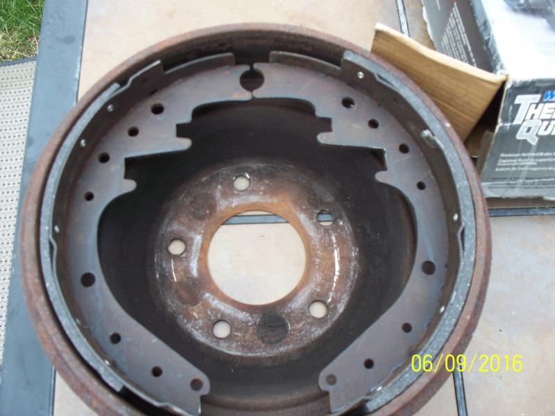

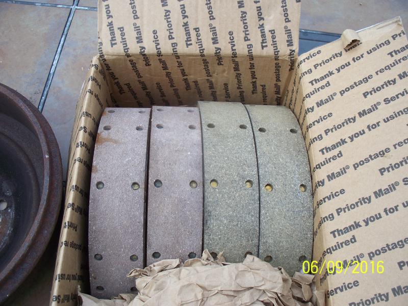

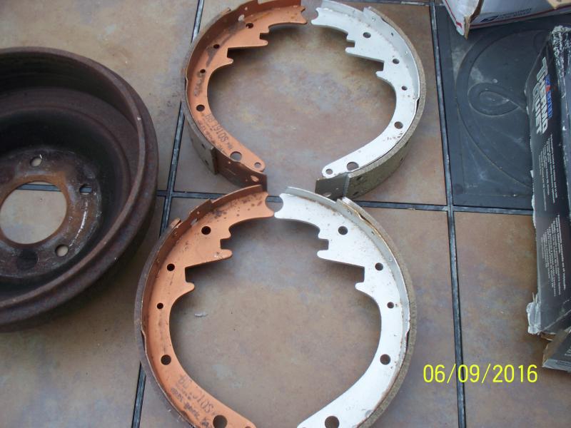

I have not found Vintage Asbestos Brake shoes for up front.
I have Wagner Thermo Quiets for up front to try out fitment.
The Vintage Asbestos P/8 brake shoes for the rear should be in next week.
Think I will photograph & post for future reference here.
