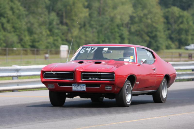

1969GTO 07-12-2016 09:23 PM
No Auburn posi trouble here
2 Attachment(s)
Attachment 432585
Attachment 432586
:drive: :clap3: :Peace: :horn::car:
