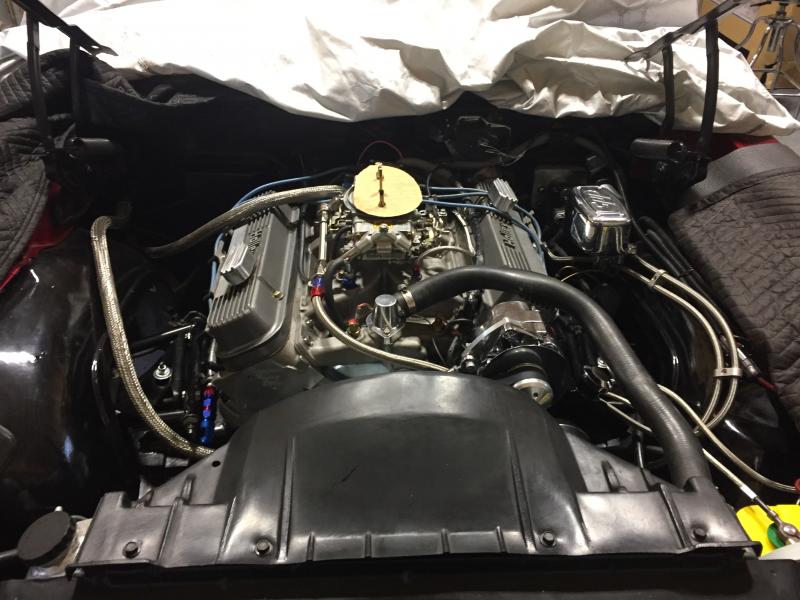

hdinch 12-24-2016 08:41 PM
Attachment 443249
Running a hydratech hydroboost system with 461, pic attached is on a newly built 461 not yet running. The hydroboost system solved my vacuum issue and now had solid brake feel and stopping power. Very happy with it.
