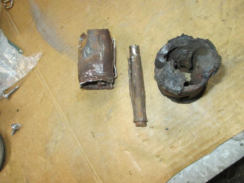

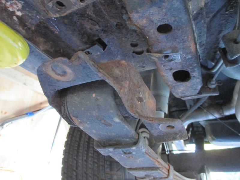

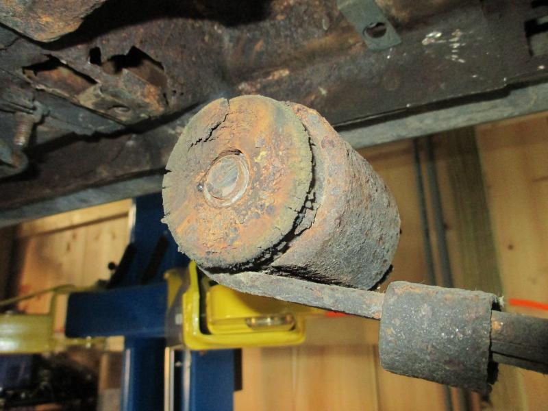

killakev 08-23-2017 09:54 PM
5 Attachment(s)
[ATTACH]461798[/ATTACH
The car without the connectors
Attachment 461799]
The connectors cut to clear the floor brace and pan
Attachment 461802
The front of the rear leaf spring. Shackle still attached since the bolt is frozen to the bushing... of course it is.
Attachment 461801.
The 49 year old bushing with the bolt head ground off.
Attachment 461803
49 yr old bushing and bolt beaten into submission...

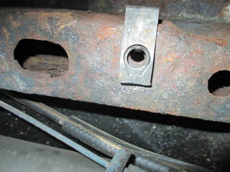

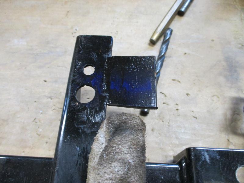

killakev 08-23-2017 10:08 PM
5 Attachment(s)
Attachment 461804
Attachment 461805
Other modifications needed. One hole need to be extended in order to line up. An extra piece of metal needed on the other connection point which will be drilled out once the other bolt is lined up.
So see where this is going? I knew that the connector need to be cut to aviod the floor brace but the bolt holes not lining up so badly? I called Jeggs to complain and I got ****....yeah well you know how it goes going to need to modify..blah blah blah. .I'm like really? the bolt holes don't line up? Would the Hotkich line up? or the Competion enginnering? maybe or maybe not
Attachment 461806
Attachment 461807
New C-Clips installed.....yeah that wasn't so easy.
Attachment 461808
An example of how far off the bolt holes are......Don't buy this my friends. I will chug ahead and beat this. Alot of extra work that was not expected.
