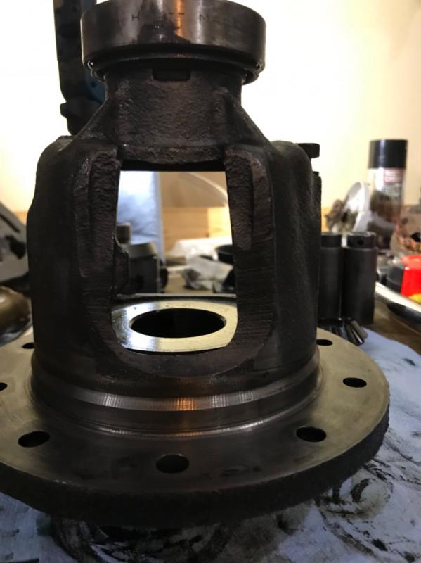

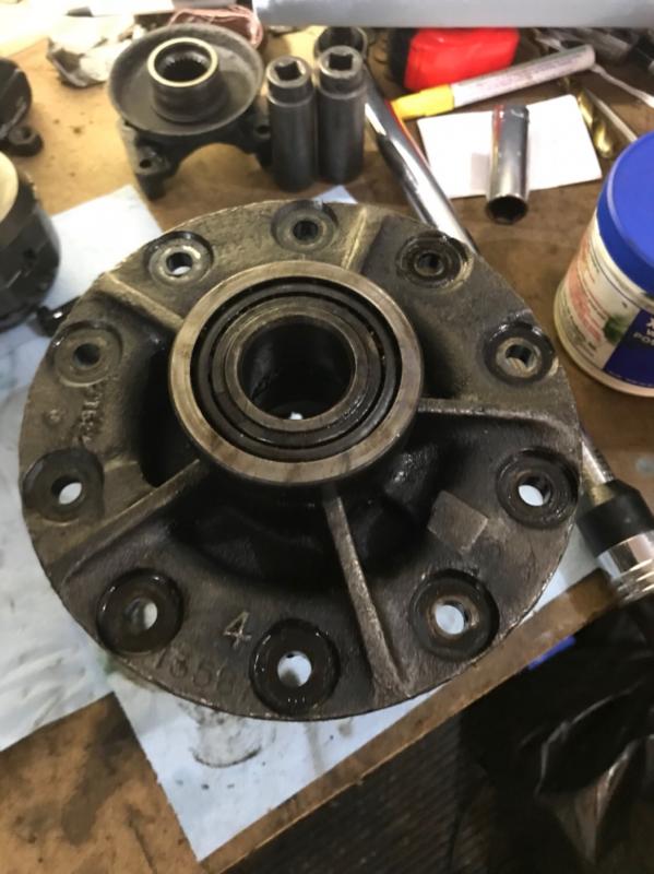

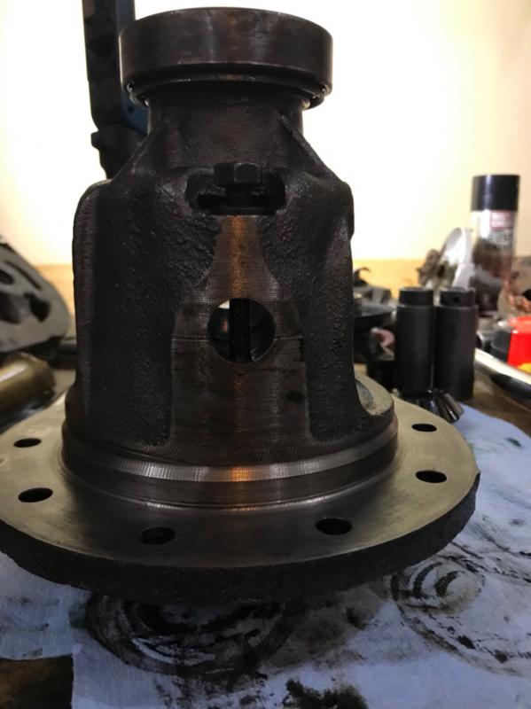

I have a 65 Lemans and had purchased a used Powertrax no slip locker to install and come to find out it appears that at some point a GM 8.2 carrier was installed in the car. The Pontiac carrier uses a .800" cross pin and the GM .7325" pin which is what my car has. Ideally I'm looking for a open carrier that will work with the stock 3.08 gears but I'd be interested in 3.23 3.36 ,3.55 car has a M20 and will be getting a 455 in the next year or so currently a 6 cylinder. Im located in Canada so the killer may end up being the shipping but interested to see whats available

I have a 1965 Pontiac Housing but I'm pretty sure that at some point a GM 8.2 carrier was installed because the Powertrax locker I went to install the other day worked great until the cross pin would not fit, tech support told me the Pontiac 8.2 used the .800" cross pin and the current one in my car is smaller at .7235" which they told me was GM.? if that makes sense wanted to use to locker I had already bought but might be better off getting a new posi carrier installed and sell the powertrax
ponyakr 11-19-2017 12:16 AM
I've never heard of putting a Chevy 8.2 carrier into an 8.2 BOP housing. So, you may need to get someone to help you make a positive ID on exactly what you have, before spending any more money on it.

I pulled the carrier from the car today. Pinion is 27 spline. Ring gear is mounted with 10 3/8” 24 bolts so from what I can tell it’s a Pontiac 8.2?
Attachment 468049Attachment 468050Attachment 468051Attachment 468052Attachment 468053
