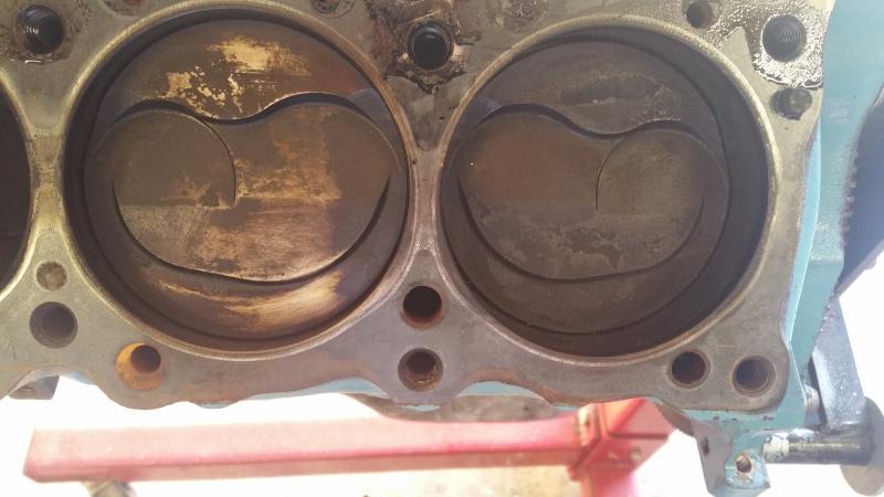

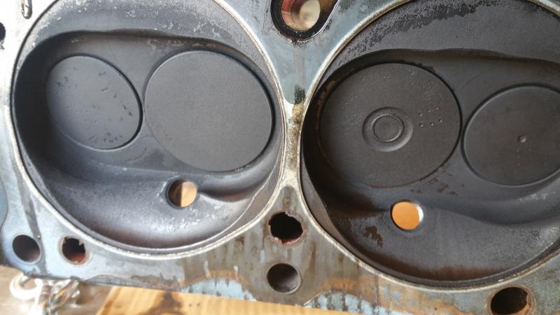

2 Attachment(s)
[ATTACH]Attachment 470018[/ATTACH]
Took the heads off, domed pistons, that changes everything.
Anyone seen a dome like this? any idea on CC?
455GRIN 12-13-2017 05:43 PM
I wiped one down looking for numbers, didn't see any. The others look oily. any ideas?
Indianhead 12-13-2017 08:12 PM
The largest I can remember from yrs ago were 15cc most were 8-12cc. I don't recognize those in particular but that may get you in the ballpark of a cr range without cc-ing them.
455GRIN 12-13-2017 08:40 PM
Just from looking at some pics from Summit, these appear to be Keith Black KB-347 pistons. If I'm reading it right there are zero CC. Still need to CC the head but if its 109CC that is about 9.5 to 1 comp? From the pics about something wasn't happy, really oily pistons tops.
steve25 12-14-2017 07:14 AM
Do the Pistons rock in the Bore?
Do the back side of the Intake valves look oily?
What do the heads have for valve seals , white Telfon type's?
