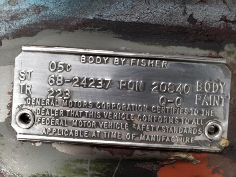

68pongto 12-15-2019 11:10 PM
The only place where the full VIN is stamped (actually embossed) on a 68 GTO is the dashboard.
There are partial VIN's stamped on the frame, engine block and transmission. An example would be 28P123456. 2=Pontiac Division, 8= 1968 Model Year, P= Pontiac Michigan assembly plant and the last six digits will match the last six of your VIN, assuming your car is numbers matching.
There is NO VIN stamped on the data/cowl tag, I have an example picture; 05C is the build date, 68-24237 = the year and the model, 2=Pontiac, 42=GTO and 37 =Coupe. The 20840 = the 20,840 GTO coupe built at the Pontiac plant. 223 = Black bucket seat interior and Q-Q = Verdoro Green upper and lower paint, but again there is NO VIN on these tags.
Also starting in 69 I have seen the partial VIN stamped on the firewall under the heater box/blower motor, but I have never seen it stamped there on a 68.

John O. 12-16-2019 12:39 AM
U r right about cowl tag, I wasn’t thinking. Is this ur tag or an example? After the build date mine has a bunch of numbers. Car was built in Fremont and where ur pic shows PON as plant mine has what appears to be DFO. Engine and trans not original.
68pongto 12-16-2019 01:25 AM
Yes, that is a picture of one of my trim tags. The code you are seeing on your tag is BF=Freemont plant, the digit is 0 (zero) not O. The zero is the start of your body number. The two sets of numbers that are after the build date are some internal sequencing numbers. Some plants put some sequencing numbers on the tag, some didn't. It has been discussed a few times here on the forum and nobody really has been able to decipher any of the internal seq. numbers.

68gtoMN 12-16-2019 09:58 PM
Attachment 526822
The information regarding the the 6-digit serialized production number of the car produced is mistaken. That represents the 20,840th V8 car produced across all models and does not correlate to overall GTO production! :-) GTOs produced at that plant will be far less than that number at that point-in-time.

68pongto 12-17-2019 01:10 AM
I would have to respectfully disagree with that statement. I have collected data on over 500 68 GTO's and have it all in a spreadsheet. The highest GTO coupe body number I have from the Pontiac plant is body # 26154, 07C build date, and VIN sequential #370088. So that car was the 270087th V8 Pontiac built at the Pontiac plant since the sequential for all V8 plants started at 100001. Six cylinder VIN's started at 600001, I have not collected a lot of data on those cars. But by far the Pontiac plant built the largest amount of 68 Pontiacs. The home plant probably built close to 40% of all 68 Pontiacs.. Also I have data on a 68 GTO conv. that is a 07B car and it's body # is 3859, obviously the Pontiac plant didn't build 22,000+ cars in one week! The convertible's VIN is 361454, so that is a difference of 8,634 V8 cars built at the Pontiac plant. Another example is the difference between GTO and LeMans production, I have a 04E GTO coupe with body # 19545 vin 292899, a 04E LeMans coupe with body # 31575 vin 298687, then a 05B GTO coupe back down to body # 19801 vin 301991. All the plants exibit the same sequencing of body numbers to vins, except for one, the Framingham MA plant. Your statement holds true to that plant only, but that plant was the oddball. I can also deduce that the Baltimore and the Pontiac plant built about 4000 convertibles each for a total of 8000, the other 4 plants built the remainder of 1,980 conv. GTO,s. The Pontiac plant built about 26,154 GTO coupes, or about 33% of all coupe GTO's. I have data on the Framingham plant of a 07C GTO coupe with body # 104787 and VIN # 142443, also a 68 07D Chevelle with body #107044, so I think they sequenced body number regardless of make, but like I said that plant is the odd-ball and the only one that I have seen that did it that way

No, nothing like that. In referring to the data I have collected, it is from many sources, ebay, internet, this forum, salvage yards, car shows, my own cars, etc. I take pictures or save pics. of just about every trim or vin tag on 68 GTO, LeMans, or Tempest I see.
