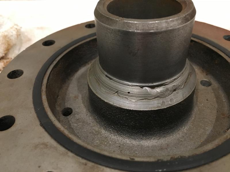

Is an original harmonic dampener rebuildable? I have one that the inner machined piece that contacts the seal has cracked and someone attempted to weld it back to the flange. There's no way I trust this, and wonder if anyone has attempted to press the inner piece out, and press a new one in? Is the rubber material that separates the inner piece from the outer available?

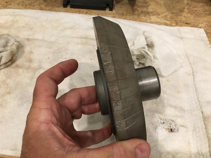

Actually, I have the same one that Tom does.
Attachment 537445
b-man 04-15-2020 07:49 PM
Looks like Tom has you covered then.
At a glance it looked like a common balancer.

Not a problem. I was trying to show the crappy repair on it. Honestly, I might still use an aftermarket item if this it too expensive to repair. I want to try to keep it original looking, but perfectly willing to use other parts - especially if it improves the reliability.
