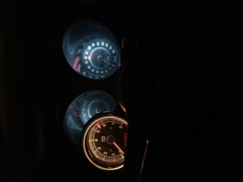

On my 79 TA, I also changed the color inside of my cluster housing from the original blue to white, since I wanted to be sure the light was as bright as possible. I used gloss white for better reflectivity.
I also re-colored the back side of the black face of the cluster. You can influence the color of the light that way. I believe it was originally a light green color, which I didn't like. I painted it with a shade of blue that I preferred, which gives a slightly bluish tint to the bright white light, and it looks great to me.
Here's a night photo. You can only get an idea of the extra brightness from this. The camera was not able to reproduce the true bluish color of the lighting. It couldn't even reproduce the yellow and red on the tachometer for some unknown reason. It looks much clearer and cleaner in person, with more color, without the foggy or halo look you see in the photo.
