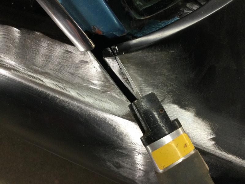

[ATTACH]Attachment 559220[/ATTACH]
Had a good gap...until the end near the Windsheild....Fiddled and tapped ...but not getting anywhere. So go out the air saw ...and made a slit....then removed a little more metal from the slit....then with a screwdriver ,make the gap I wanted and welded up the seam. Like new now.

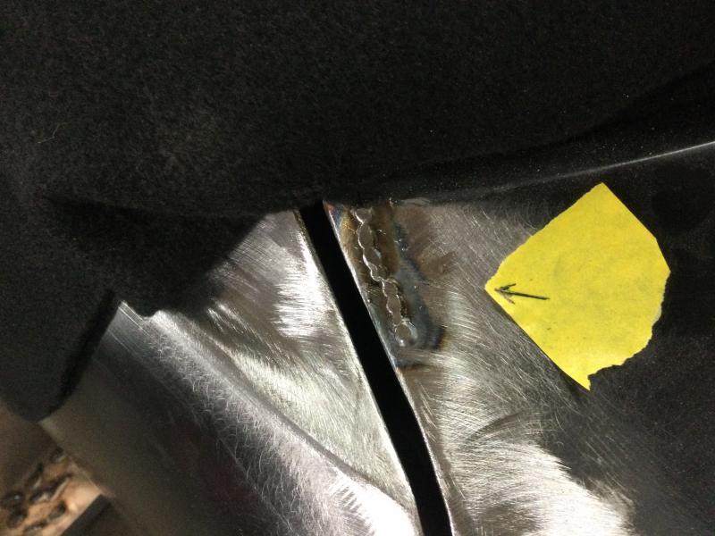

Attachment 559221
Some grinding and a wee bit more welding ....and a nice gap now. Hope this helps

The pics don’t really show how far off that gap was.....but you get the picture
