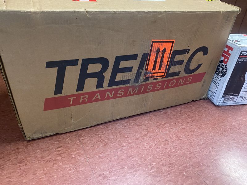

6T9GTO 06-15-2021 01:13 PM
Well it's her now. I guess I got to get that bellhousing indexed...

6T9GTO 06-15-2021 01:28 PM
2 Attachment(s)
Attachment 568272
Attachment 568273
PontiacMatt72 06-15-2021 10:41 PM
Very nice. Looking forward to updates!
pokey1 06-16-2021 01:00 AM
Yup looking very nice. should be an easy install and make a whole different driving vehicle. Mine is night and day difference.
