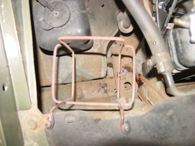

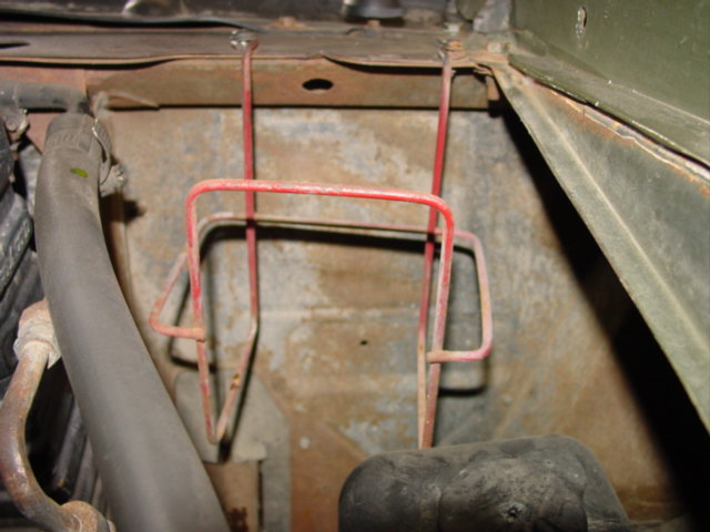

dmorg1 01-06-2022 08:01 AM
5 Attachment(s)
Johnny,
Not pressurized but here are a few pics of an aftermarket setup that looks period correct. I am sure that you can easily fab the basket but locating a tank may take a bit of searching.
Attachment 581484
Attachment 581485
Attachment 581486
Attachment 581487
Attachment 581488
Dave

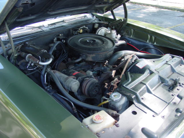

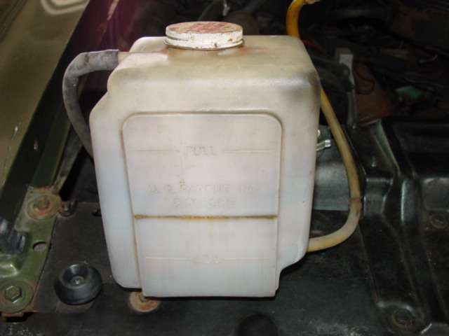

OG68 01-06-2022 12:54 PM
2 Attachment(s)
This is from a mid seventies Nova. Partially hidden under the passenger fender. There is a reproduction available from the Chevy vendors. (OPGI, Classic etc)
