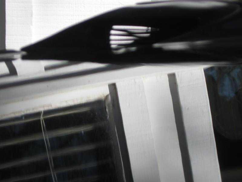

Attachment 593783I've done a few of them over the years, and found an easy way, and it leaves the ribs intact. I take a die grinder with a cut-off wheel and make passes along the back side of each cup until the rear of the cup is removed, leaving the ribs. It only takes a few minutes and looks great. The weird reflection on the hood is the blinds on a window on the house.
