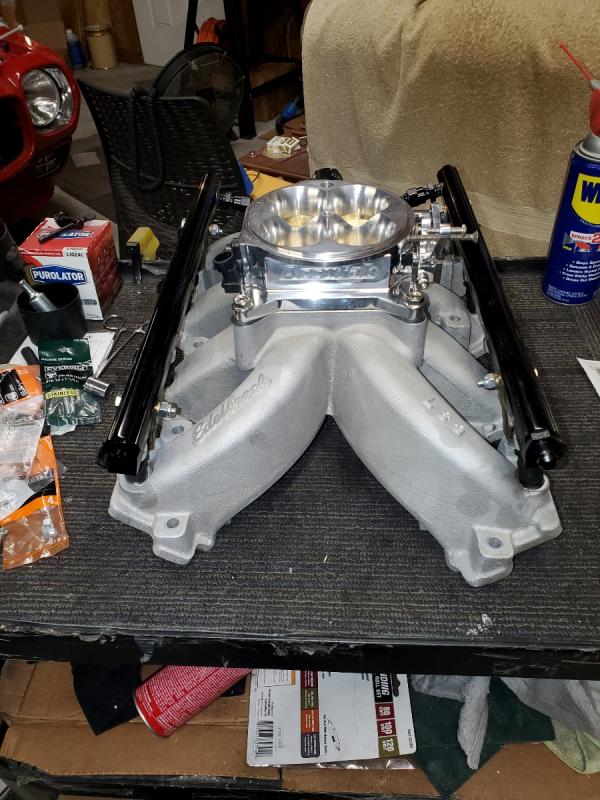

FrankieT/A 01-29-2023 01:00 AM
3 Attachment(s)
Terminator X
Attachment 606254
Attachment 606255
Attachment 606256
