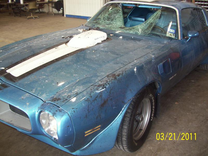

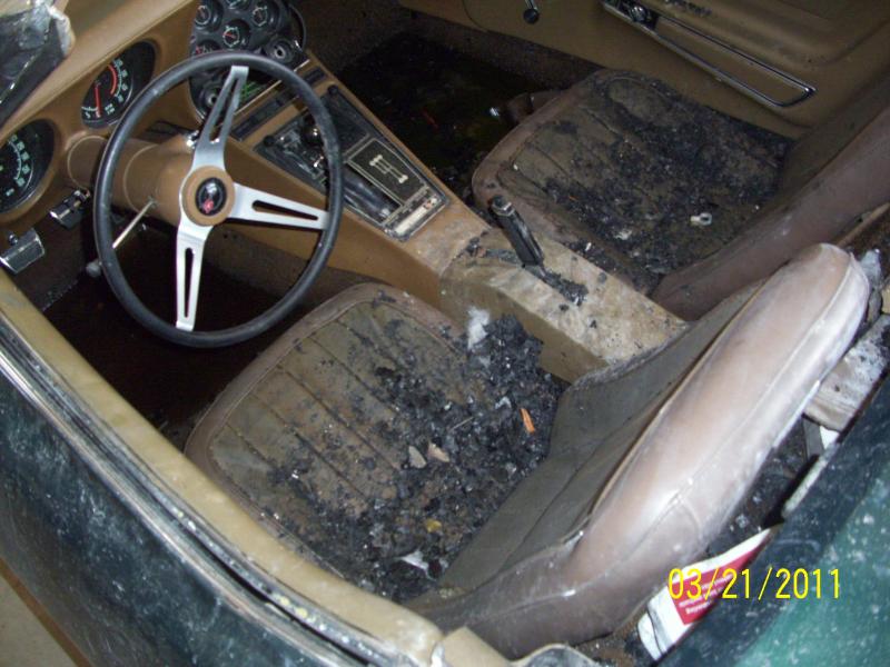

I lost a house to a fire 10 yrs ago, not fun. 4 classic cars were hurt but not totaled, the house burned over the garage and burning joists. etc fell on them. Btw Hagerty came through like a champ.
I have had 4 under hood fires in my life and i think an Element stick would have been perfect for each. For one I extinguished with coffee and a fortunately located puddle!
Attachment 611782
Attachment 611783
