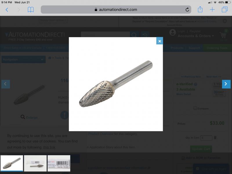

I’d clean up those areas with a carbide rasp tip...in a drill...or something that spins faster...like my whizz wheel. Clean up the loose rust ....and feather edge sand with 180...and apply one coat with an acid brush...wait 20 minutes ...the follow with a second coat.

MUSLCAH 06-21-2023 09:15 PM
Attachment 614614
Here’s a pic of that rust busting tip
