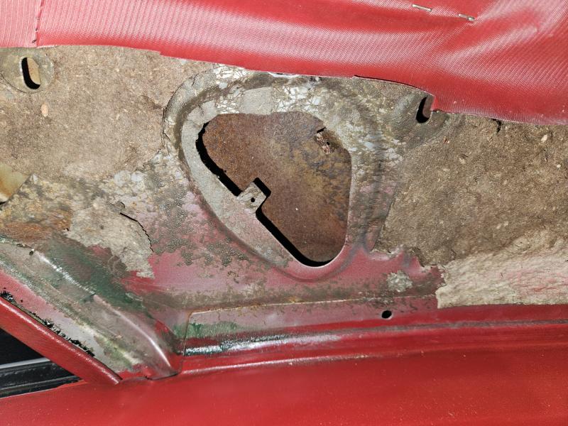

The right side sail panel is loose and bowing out so I removed it to check what is underneath. Looks as if the critters have had a good time chewing the jute backing.
I'm planning on adding more jute then holding the middle in place with velcro.
However, in the body, there is a hole with tabs. Not sure why the hole was there but did the factory use the tabs to hold the sail panel in place?
Attachment 616291
limejudge69 07-19-2023 03:59 PM
Yes the factory used metal clips to hold the sail panel in
