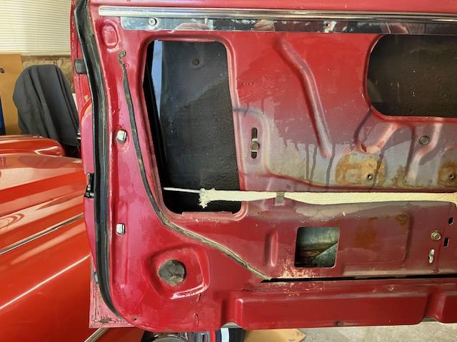

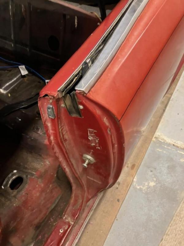

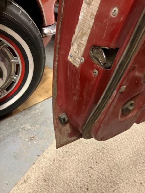

geeteeohguy 12-01-2023 04:15 PM
3 Attachment(s)
Attachment 624140
Attachment 624141
Attachment 624142Behind the door panels, too. Here's my original paint '66 with the panels off.
